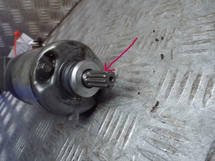

29 Feb 2024 09:49
#895749
Is this what you are referring to? if so I believe it is part of the armature in the motor

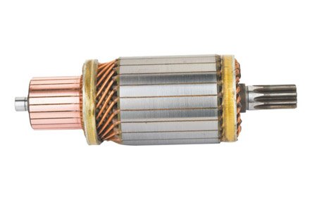

Thank you for your reply, but the part I'm looking for is the small gear on the end of the starter motor shaft.  I have recently seen it called a "spur gear".  I suspect I may have to visit a junk yard or maybe a starter repair shop would have one.
The very small gear on the end of the starter is actually the splined part of the armature shaft as can be seen in the example pic below.
It is not replacable unless you either fit another armature or complete starter motor..
