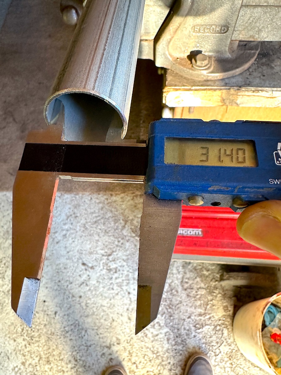

I have been lucky enough to find a piece of stainless steel pipe the right inside dia 31.5mm, so I will make some clamps up & fit this when I get time.

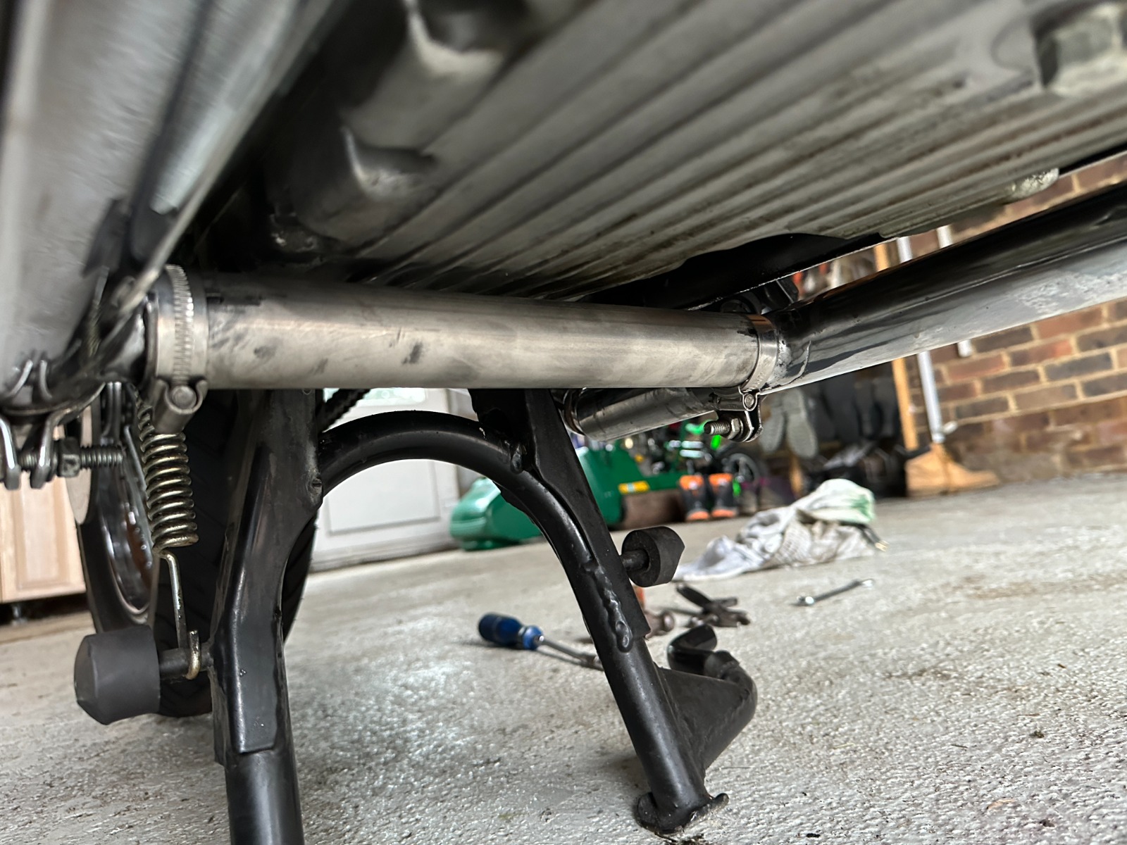

Decided to replace my missing cross-over pipe today, I believe the original had rotted away.
I managed to get hold of a length of st/steel pipe the other day that has an internal dia of 31.5mm which is absolutely perfect to fit on the original down pipe stubs.
I cut a piece 270mm long, put a couple of splits in it 20mm long from the ends & it fitted perfectly.
I don't know if it will make any difference or not, we will see.

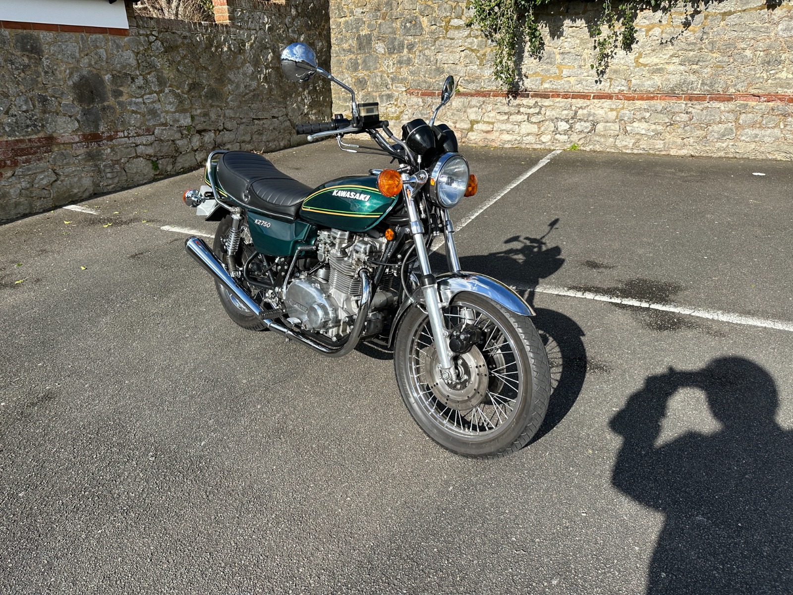

Re: Exhaust cross over pipe on KZ750 twin
16 Feb 2024 06:11
A lovely morning to test my new cross over pipe today, can't really say I noticed much difference though.
