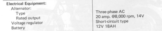

Below is spec for 81-83 "J" charging system. If you go for a lithium battery make sure you use a MOSFET reg/rec with a stable output (I would also recommend a 30a fuse in the reg/rec output to the battery to avoid possible "thermal runaway's" FIRE)
