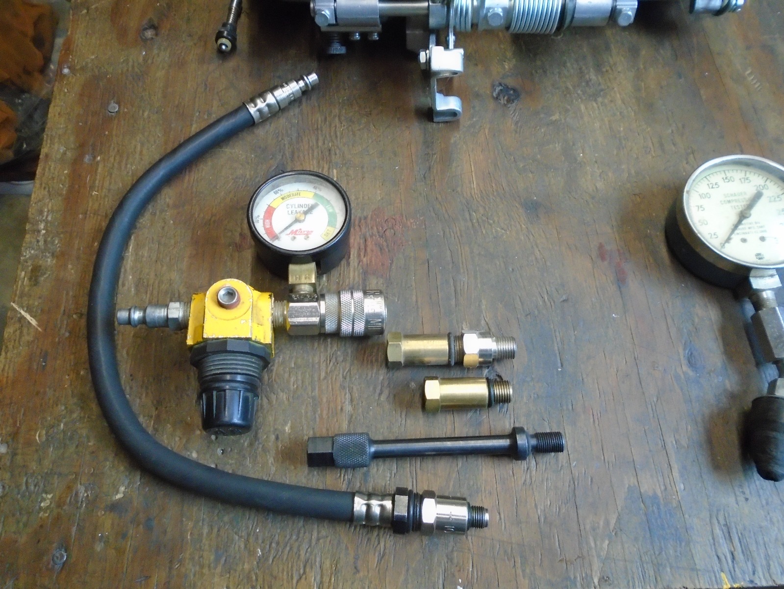

Just FYI start with a leak-down test, always my first go to. If an engine has been sitting for some time and as normal some valves have been sitting open you will get a false reading initially. If after starting, then take your compression test and then with a Leak Test. You'll figure out mechanical tolerances quickly.

Before leak testing ensure the bike is in gear, the rear wheel is clear of the ground and the rear brake is jammed on (the motor can try and turn when air pressure is applied to the piston and if in gear it can kick it off the stand)

Highly unlikely the pressure will spin the wheel on a 4-cylinder?? Unless You Have it in gear and have your compressor set to 500psi, ha. Just take a straw or similar tool and "feel" the piston crown, both ways till you establish what feels like TDC. Like Wookie said the piston "can" slide down but that means, you didn't have it at true TDC yet. This can be a challenging test on the twin cylinder CB350-400's because of the lobe location but a walk in the park for the Z1/KZ models.

04 Feb 2024 14:04 - 04 Feb 2024 14:05Clay I'm not looking to start an argument and you obviously "know your stuff" but I have seen cars "load up" on the E-brake at 120 psi when leak testing. One thing age has taught me is that if something has the potential to "ruin your day" then it's best avoided if practically possible.Highly unlikely the pressure will spin the wheel on a 4-cylinder?? Unless You Have it in gear and have your compressor set to 500psi, ha. Just take a straw or similar tool and "feel" the piston crown, both ways till you establish what feels like TDC. Like Wookie said the piston "can" slide down but that means, you didn't have it at true TDC yet. This can be a challenging test on the twin cylinder CB350-400's because of the lobe location but a walk in the park for the Z1/KZ models.

Yeah, possible "perfect storm" scenario - all plugs out, piston near TDC, bike in gear, apply 150 psi to cyl (about the same as normal compression, btw), and wheel could spin. Better safe than sorry - murphy's law can strike when you least expect it !
