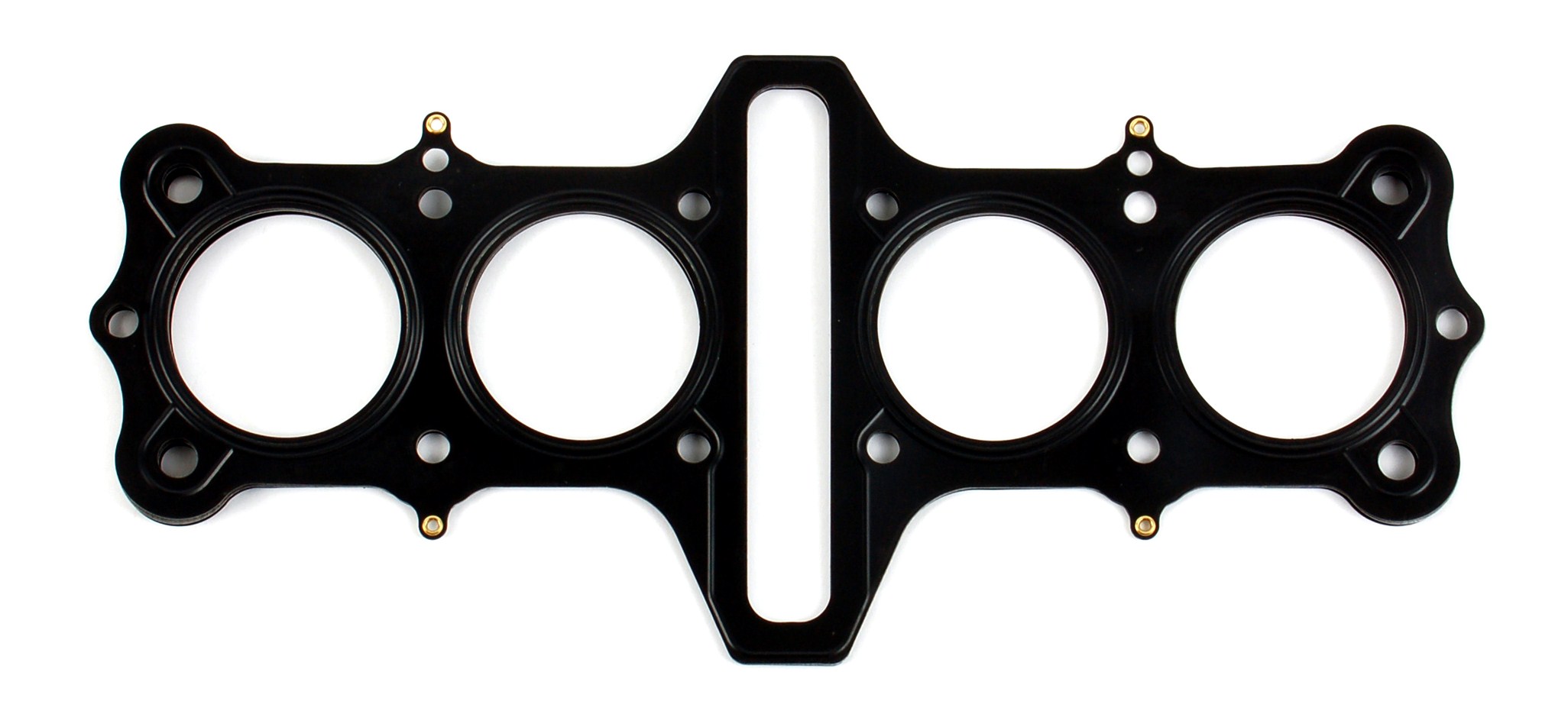

Wiseco K1172 piston kit includes a Multi Layer Steel MLS head gasket per image below:
Received confirmation from Cometic that NO sealant fill is necessary in the 11009-1208 o-ring recess around the cam chain opening, or at the outer four cylinder stud holes where 92055-1148 o-rings are used with J-motor cylinder blocks, when using a Cometic MLS head gasket.
