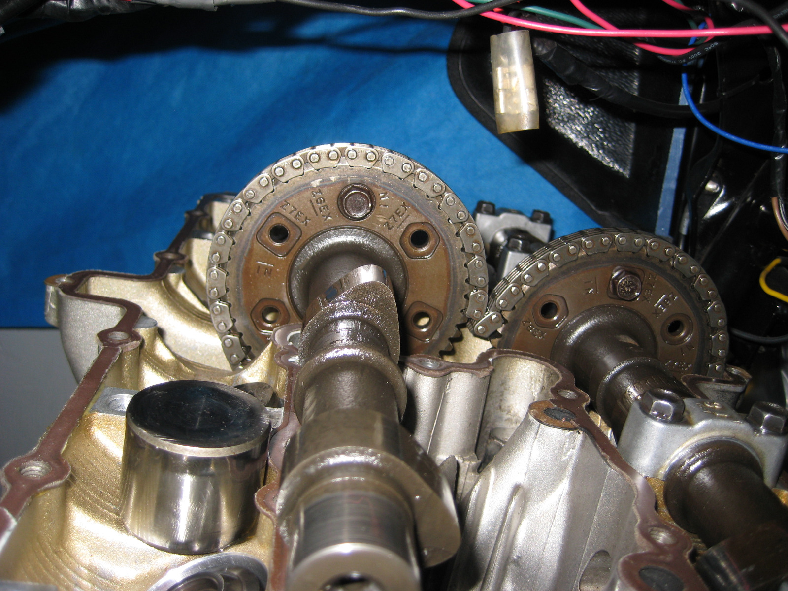

I have worked on 650's a lot and have found doing one side at a time is the way to go - don't unbolt both sides at the same time. This method is much faster and you don't have to worry about being a tooth out afterwards.
Measure and mark down the clearance on both sides before unbolting anything.
Take the top idler off then unbolt one cam moving it into the center where the idler would be without taking the cam chain off the sprocket.
Usually the cam will just sit in the center but you could jam a screwdriver down into the center tunnel behind it if you think its going to move.
Once you swap out the shims drag the cam back to where it bolts down and tighten up the cam caps.
Repeat for the other side.
Once you do this a dozen times or so it becomes real easy.

Last edit: 21 Jan 2024 17:17 by Injected. Reason: pic
