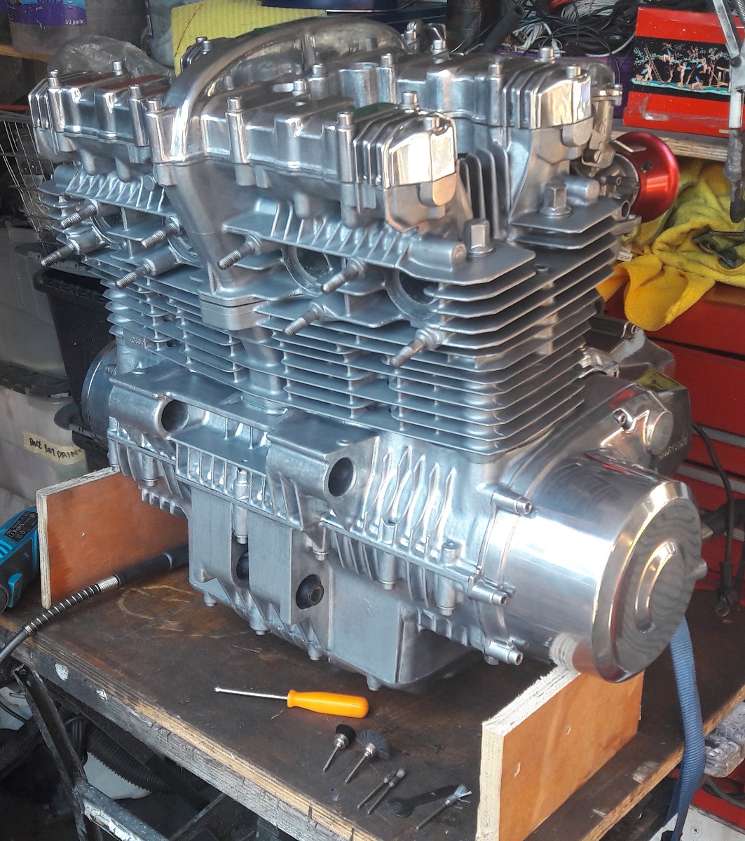

This was painted black, a combination of good paint stripper, scotchbrite, a dremel wirebrush, and elbow grease did the trick. Not gonna pretend it was quick or exciting to do but the results speak for themselves I think.

12 Dec 2023 16:18The time required to pull that off had to be extensive. We’re not worthy!!!

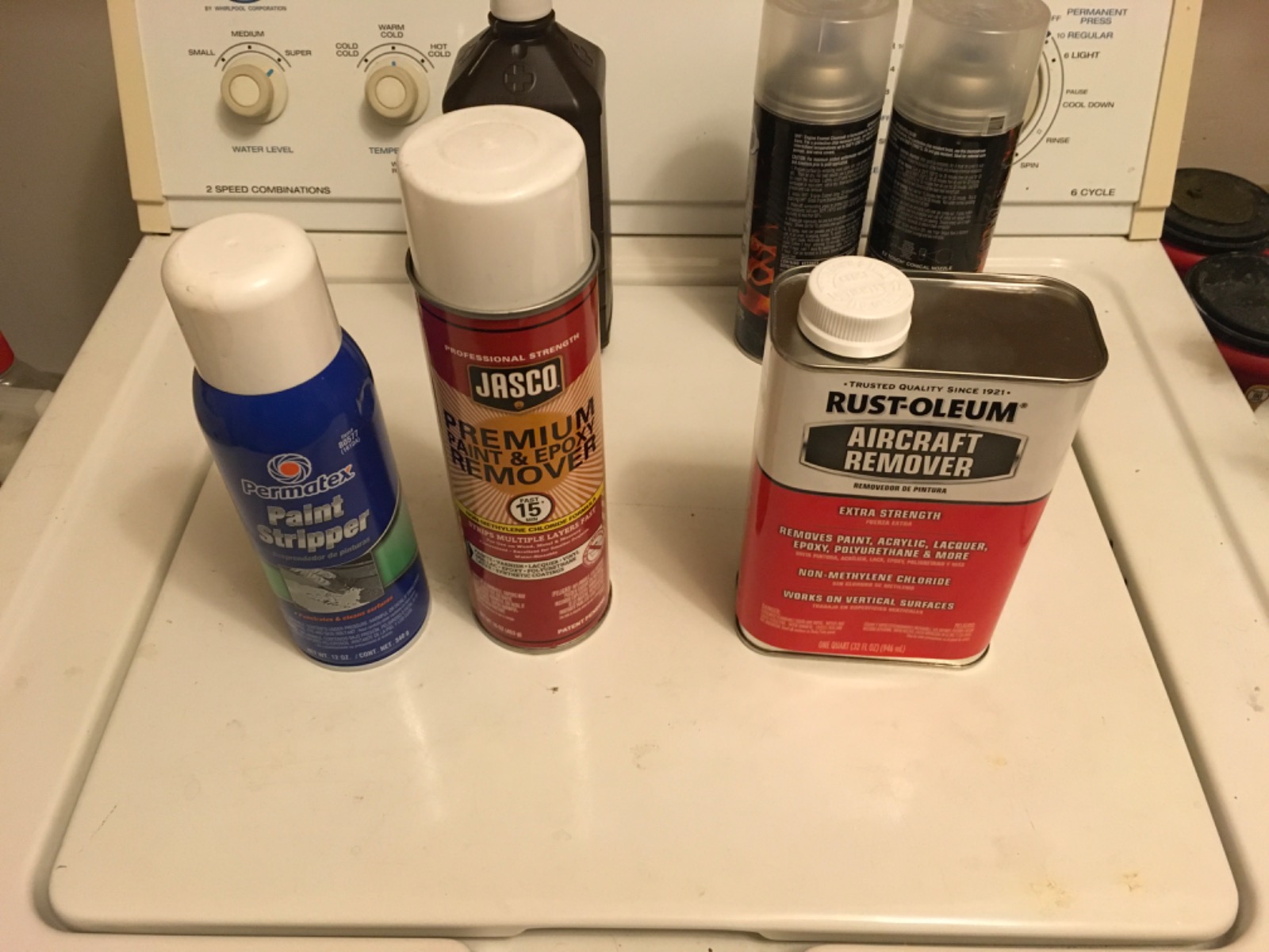

I’ve had ok success with the two on the left. Will be trying the rustoleum next. Waiting for 2 sets of hand controls to come back from vapor balst. They are just blasting the inside to remove rust and corrosion. I’m going to chemically strip the outside to help preserve the letters.

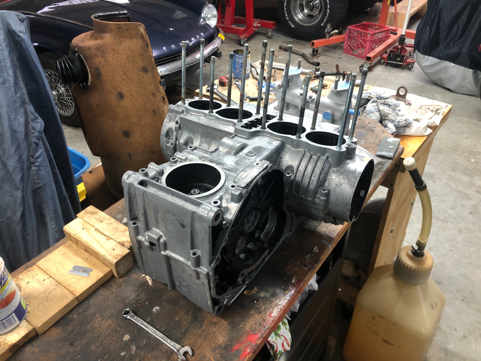

I stripped my engine cases down and this stuff did an OK job
Citri Strip
It helps to wrap it up in something. I used a large trash bag and let it sit overnight. Then I took my pressure washer to it.
It took some time but did a decent job.
