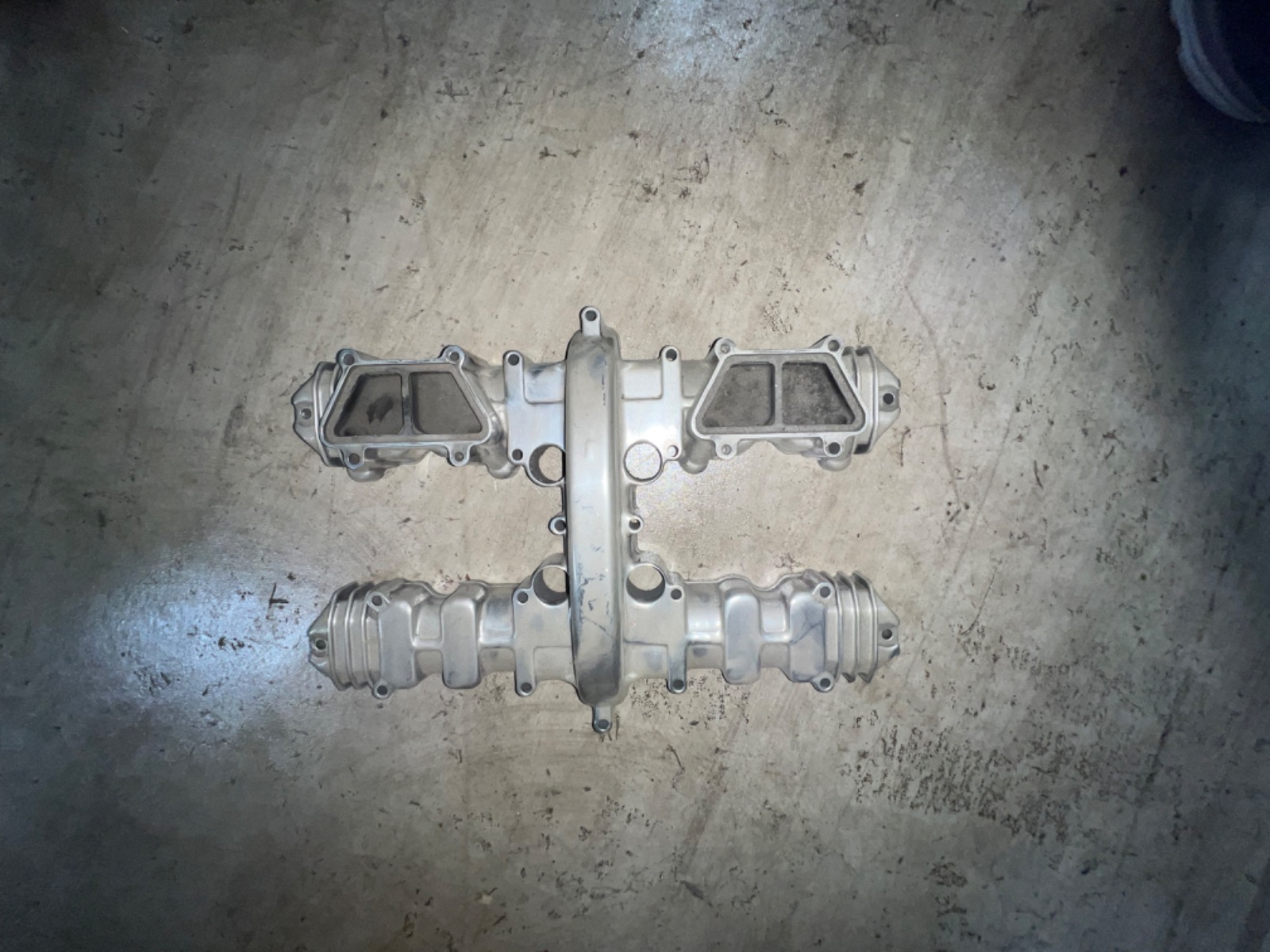

Wait. You mean the part that is shaped like an ‘H’? Is that not a cylinder cover? This item?

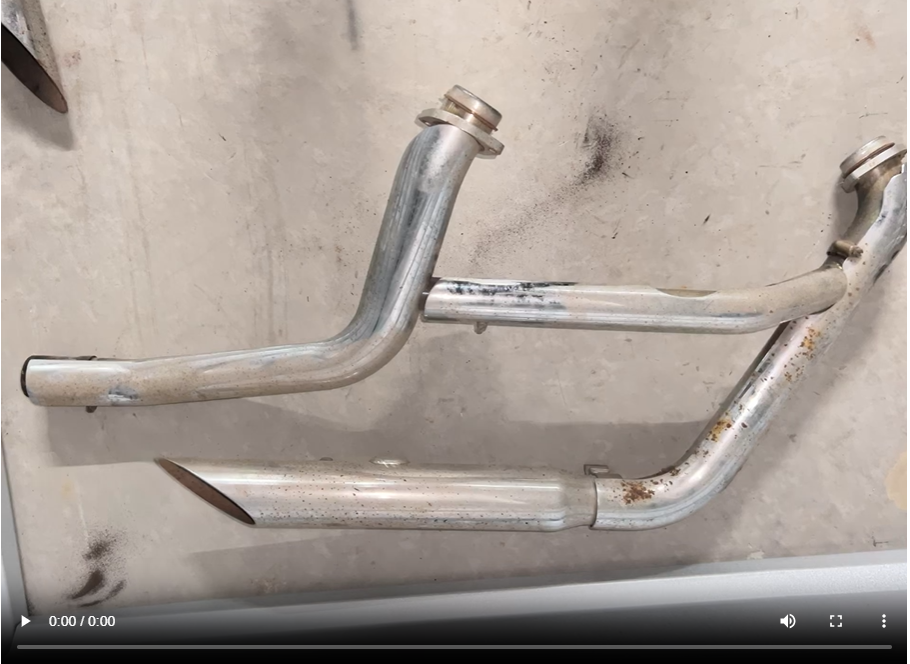

You mean the H-shaped piece?=========================
The exhaust in pic2 is from a big twin (possibly Harley) definitely not KZ

That is a valve/cyl head cover for a KZ, I meant this one

Oh. That pic slipped in somehow. Yes, that is leftover Harley gear. Thanks.

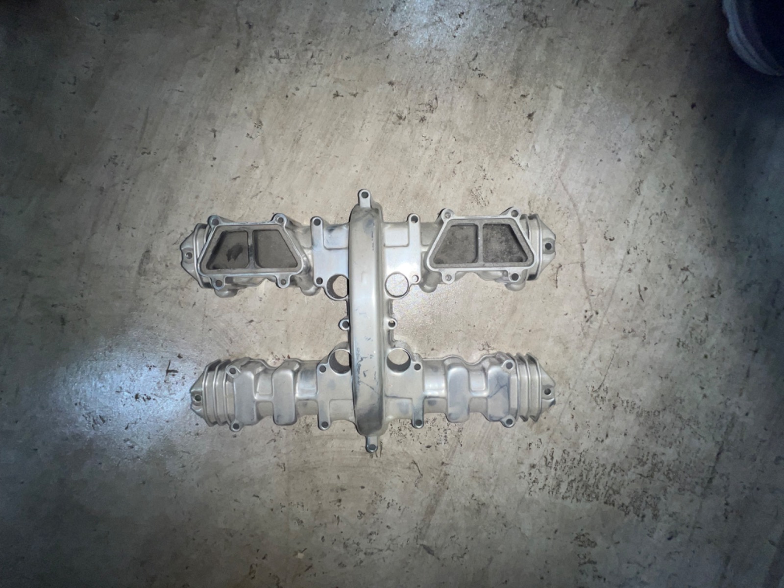

Hiya
i finally got my hand on what I think is an ignition advancer. Thank you for the tip. How do I decode the info on the advancer?

Decode
005 - The last three numbers of the full part number - 21148-005, which was superseded by 21148-010.
It fits 1975 - 1980 Z1, KZ900 and KZ1000.
TEC is the logo of the company that made the part.
T 1 F 4   T= top dead center for cylinders 1 & 4. F = static ignition firing point for 1 & 4.
T 2 F 3 is the same info for cylinders 2 & 3.
Most of this information is in the factory service manual.

Thank you!
Very helpful.
