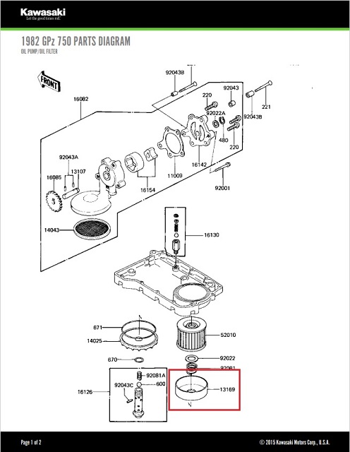

I have always followed the parts fish and assembled the oil filter with the “cup” against the oil filter cover, facing up, just as in this Gpz750R1 parts fish.

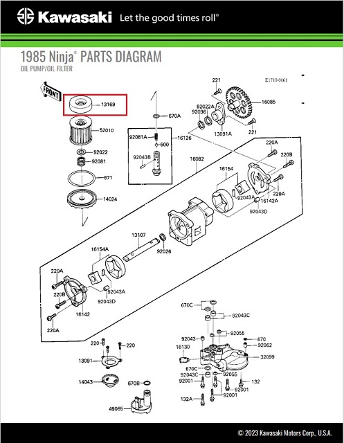

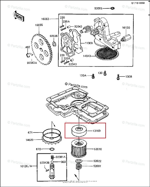

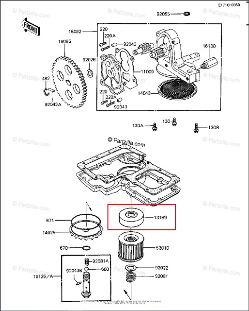

When I looked at the parts fish I noted that the oil filter cup on the Gpz900 is assembled facing upside down in my world. See pic.
The same goes for the Gpz1100 -84
Does anybody know the reason for this?
