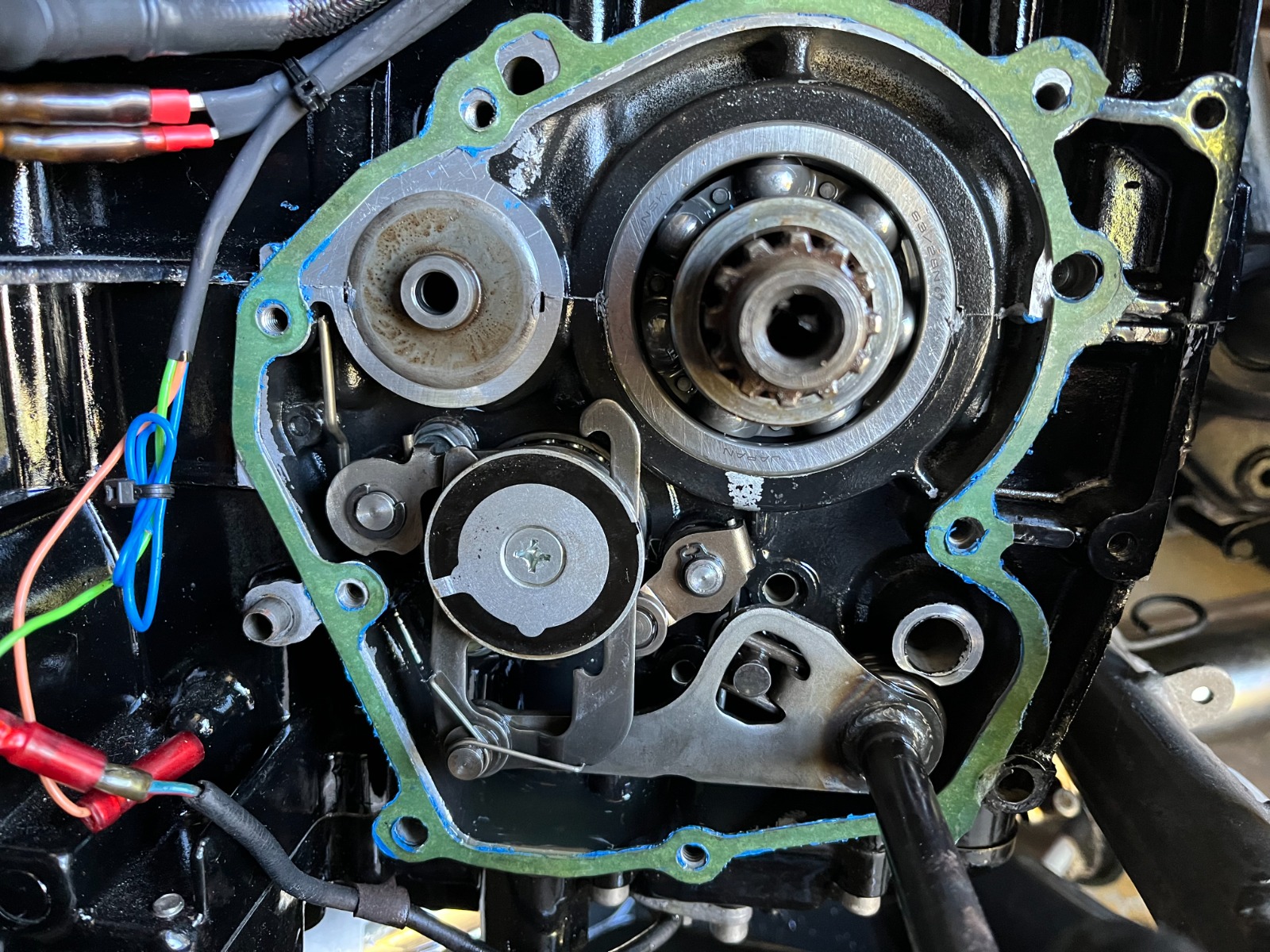

I would start by looking into the neutral positioning lever and spring.
See the external shift mechanism section in the 81-83 KZ1000/1100 base manual starting on pg 6-29.
If you remove the cover and start poking around, there's a warning note that says:
Do not pull the shift rod out more than 40mm. so don't do that. ha ha.
#13236 & #92081A

Thankyou for your reply, I have a new neutral locator and it goes into the indent as the drum rotates

Again thankyou, after a lot of thought I'm certain the balls have been removed (gears are definately not gummed up). I won't pull the motor out to fix this and put up with a vague neutral. As Martin stated I'll recheck the neutral selection lever just to make sure all is ok while I have the side-cover off.

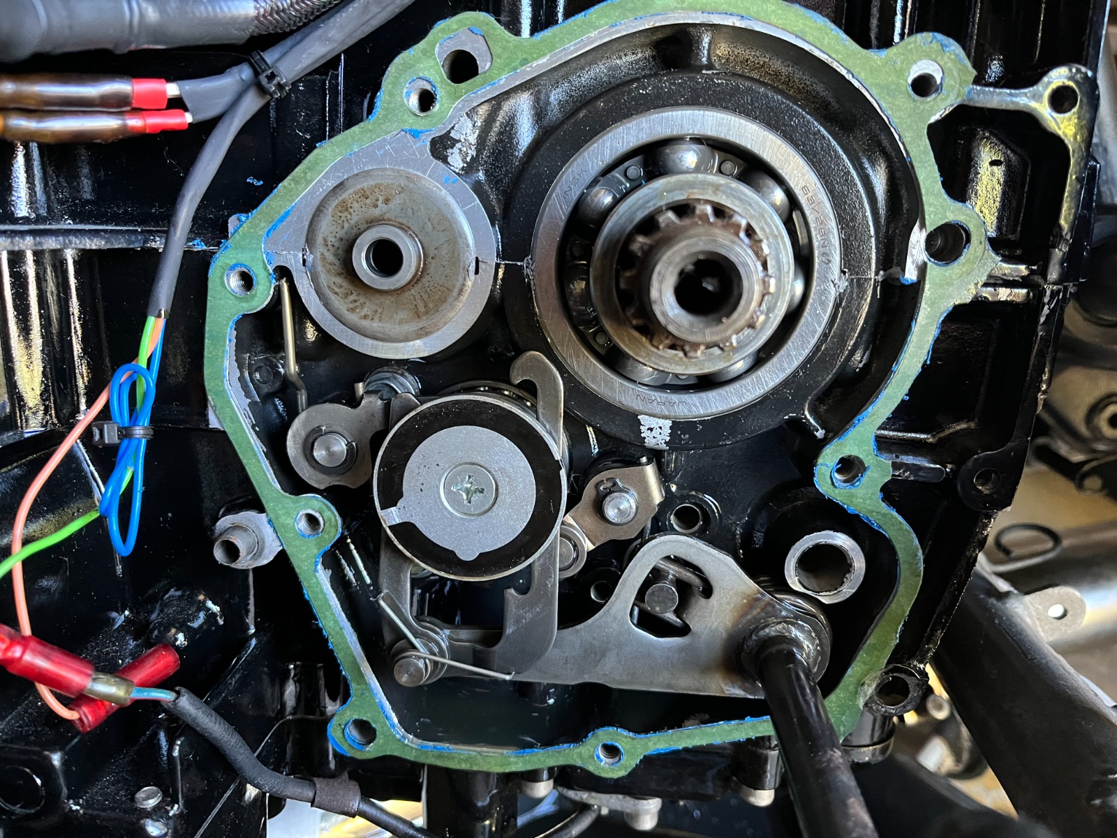

22 Nov 2023 10:53 - 24 Nov 2023 08:26Thanks for posting the image. I noticed what appears to be an o-ring just inside the clutch push-rod opening, which led me to a cmsnl KZ1100 transmission part detail:
images.cmsnl.com/img/partslists/kawasaki...ar093162105_8690.gif
Huh, there it is 670B1508
In 2015 I replaced the broken push rod with an APE hardened steel version (NLA) without the o-ring.
1982 KZ1100-A2/1170 sleeper 😀

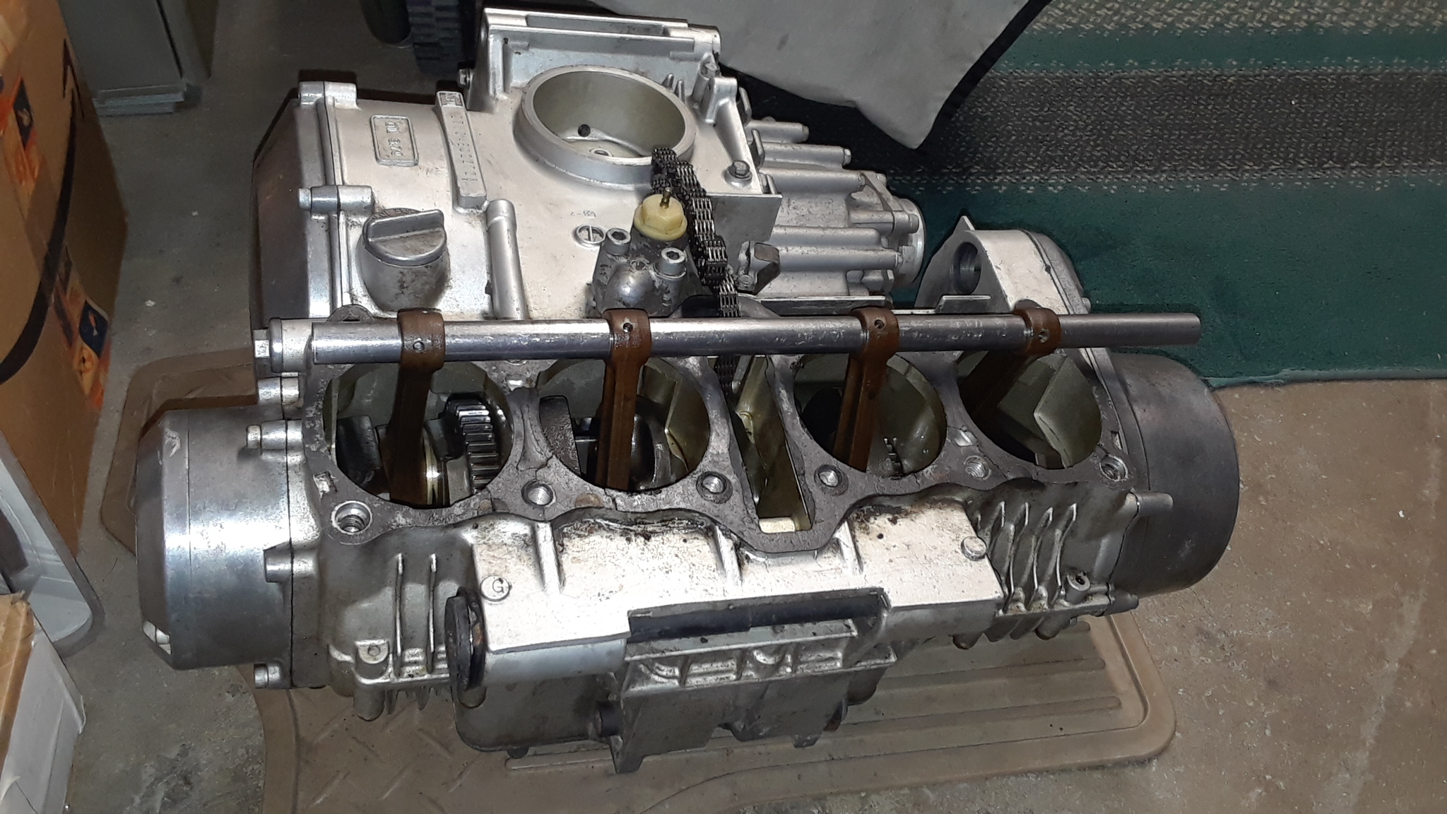

Probably the reason why this engine won't shift above neutral:

03 Dec 2023 22:04 - 03 Dec 2023 22:18
Everything behind the front bevel gear case looks in order, except that pesky o-ring is missing from this motor too...
I suppose the output shaft has to be disassembled to free up those three little balls, unless there's a chance of accessing and freeing them up with the oil pan removed. Can't imagine they're missing in this case since the engine has not been opened before.
The the clutch components check out, but several fibers were stuck to adjacent steels by dried oil, and had to be pried apart.
The crankshaft seems in good shape, though the rod movement feels restricted somewhat by thick old oil that nevertheless is clean.
Last edit: 03 Dec 2023 22:18 by daveo.

04 Dec 2023 01:23There's nothing wrong with the gearbox or lockout bearings if you can only get 1st and neutral at standstill.Everything behind the front bevel gear case looks in order, except that pesky o-ring is missing from this motor too...
