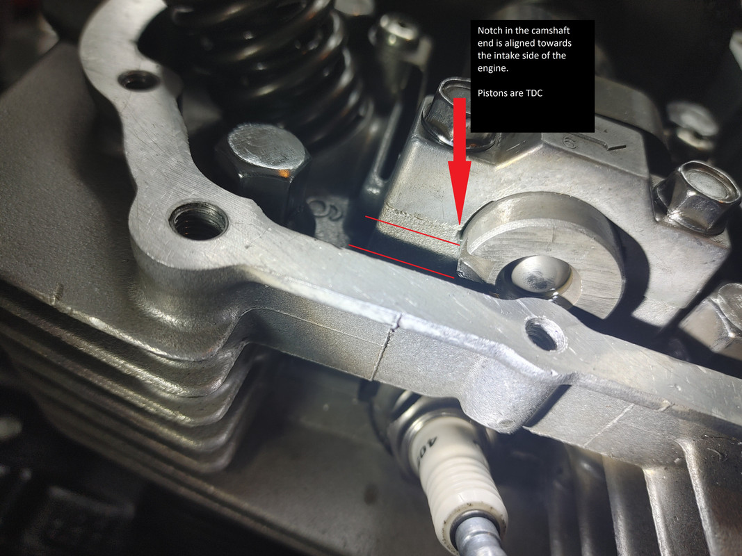

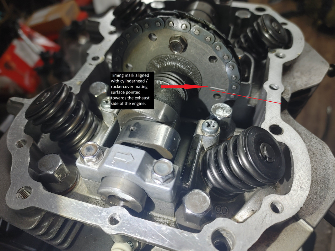

Is this the correct cam timing for TDC? 1978 KZ400B.
- NoahTaylor98
- Posts: 9
16 Nov 2023 04:19
Can anyone confirm or correct my timing here? I think i have it correct but wanted to double check.

Images are attached above. I also uploaded them to an image sharing site just in case they wont open in the above post. here are the links.

If your crankshaft is indeed at TDC, then you are good to go.
Double-check that, making sure that you pull the chain taut before rotating the crankshaft.
