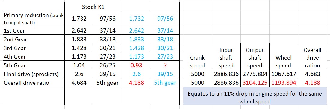

Just "spit-balling" here as I don't know if it would even fit but the below shows the effect of using a 5th gear set from a Z1300 (0.93) without effecting anything else through 1st to 4th
