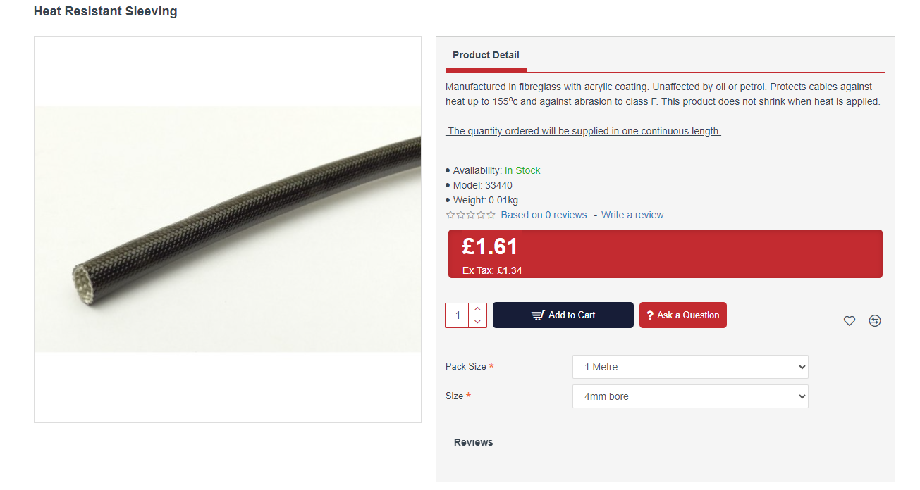

One question for you electricians out there, I had a problem with my stator wires (they were original and in a bad state so had to cut them off inside the case) which impacted my charging circuit. To repair, I used bullet connectors inside the alternator case, covered with heat shrink tube. So far it seems to work but will it be ok in the long run ? Will the oil eventually lead to this repair to fail ?

15 Dec 2023 02:42I would suggest using "heat resistant" sleeving which is available in a range of sizes (same as the yellow cover fitted by factory) you can then use conventional heat shrink at the ends to seal. As it's not constantly immersed in oil I think you will be fine.Hi all,
