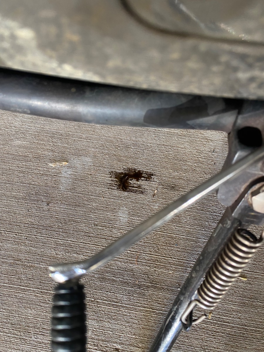

Good afternoon all, it’s been a while since I posted here but the bike is doing really well. I’ve been riding to work every day and it’s never given any issues whatsoever.
I left it parked over the weekend and it’s got more than a few drips of oil on the ground. Not like a puddle but not a drop or two. I trace it up and it’s leaking off the secondary shaft bearing cover bolt. I’ve never removed it but the manual says the seal is an Oring. I found the Oring on Z1 and matched the size to a local Napa one I got for $0.59. My question is wether or not the bike will dump oil when I remove this cover with it on the kickstand? I have the center stand temporarily removed so I can toss it on the bike for this repair if it will prevent the bike dumping oil on the driveway.

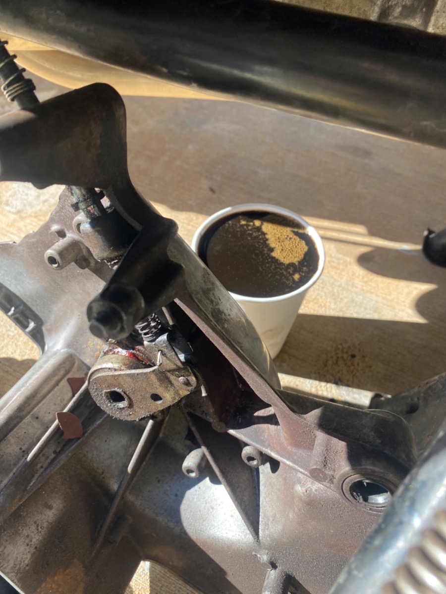

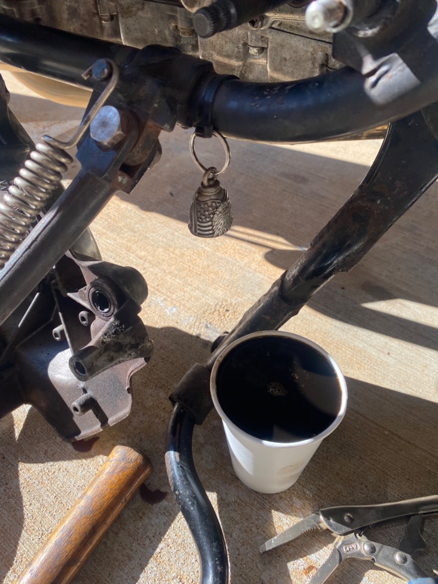

So far so good, the replacement was about 30-45 minutes and that’s ONLY because these lovely JIS screws. One I was able to get out using needle nose vise grips and the other I just couldn’t get a hold on so it had to be dremeled and flat headed out. Rode it for 10-15 minutes and no major leak so far. Now the overnight test is where we really see the truth. As to if it was a successful repair or not.
This is the leak after sitting for exactly 15.5 hours.
This paper coffee cup was filled up 2 times by the oil leaking out. The level was checked just yesterday on the center stand so it was a good fill. Probably 16 ounces each so 32 OZ of oil would have leaked.

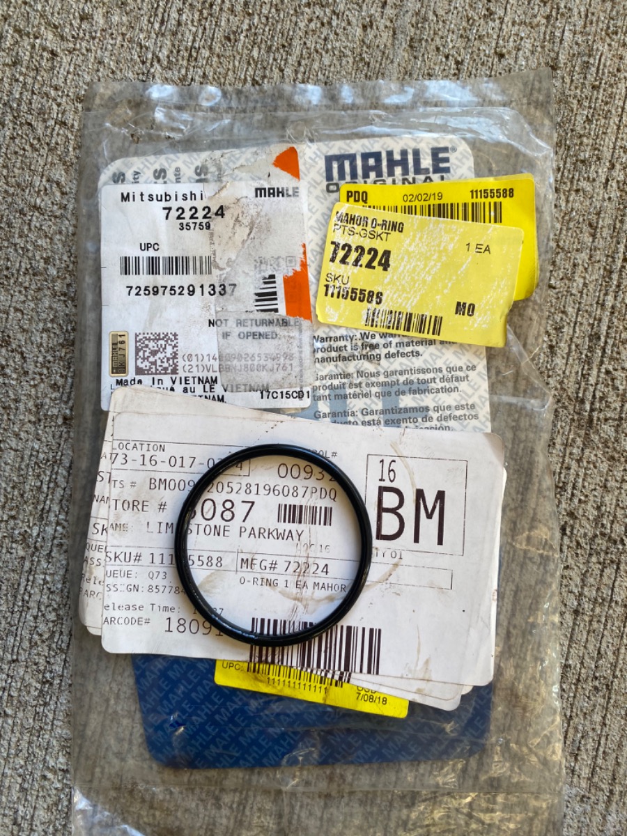

My apologies Dave, I checked again and it was actually 1300 miles ago. It gets confusing when you have to do 2 bikes, my truck, the wife’s car, and other machinery around the property.
The Oring is working great. I left it for 48 hours over the weekend and it never spilt a drop! The Oring is Mahle part number #72224. I got mine from my local Advance Auto parts for $1.49 next day.
