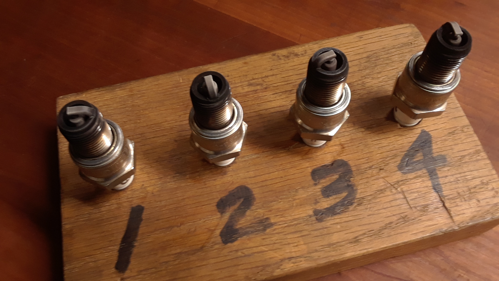

Best yet. I may have finally found it.
Timing set to 38° BTDC (corrected)
RS34 Carb Jetting:
127.5 main
30 pilot
1.0 air
3rd needle slot
1/4 +/- turn out
No popping deceleration
RS34 Carb Jetting:
127.5 main
30 pilot
1.0 air
3rd needle slot
1/4 +/- turn out

11 Oct 2023 15:30A "typo" me thinksTiming set to 138° BTDC

11 Oct 2023 16:48 - 11 Oct 2023 16:51Yes, me brain farts!
38° that is. Good eyes, guy's!
Compression: 160 psi x 4
23K stole it miles on MTC piston and ring kit installed 2019

Those are sweet, you might try stepping down one heat range. The color change on the earth strap is too close to the base ring. It should be just before the bend of the strap. Mixture is spot on, especially if these are the results of a normal ride. You have nailed it.

12 Oct 2023 16:41 - 12 Oct 2023 16:47Those are sweet, you might try stepping down one heat range. The color change on the earth strap is too close to the base ring. It should be just before the bend of the strap. Mixture is spot on, especially if these are the results of a normal ride. You have nailed it.
Thanks Matt
I purchased a set of IW27 Denso (???) off ebay and had them installed until I found one plug had a problem.
Through messaging the seller would not confirm the set was genuine Denso and did not offer to replace it, so I immediately removed all of them (ebay item 126044940631):
photos.app.goo.gl/vtzhU9eKyA96jLKP9

12 Oct 2023 16:54Those are sweet, you might try stepping down one heat range. The color change on the earth strap is too close to the base ring. It should be just before the bend of the strap. Mixture is spot on, especially if these are the results of a normal ride. You have nailed it.
Thanks Matt
Those are resistor plugs. Are you running resistor plug wires, or resistor plug caps (as came stock on your bike)? If so, you have too much resistance in your ignition. There should only be ONE resistance element in the system, otherwise spark power will be weakened
Thanks Ed,
I ran non-resistor plug wires and caps with that IW27 set, and currently with the Nippon Denso W24ES-U in the first post picture.

Running NO resistance element in the ignition system, will make for the strongest spark. Your neighbors, using the AM radio in their car, may wonder why there is so much static when you ride by, though.

Thank you Matt for suggesting that. Figured I should just take a look...
And plucked the following off ebay!
Denso w27es-u spark plugs box of 10
Condition: New Old Stock
Sold for: US $11.00
Expedited Shipping: US $12.95
PLUS 6% Michigan Sales Tax, damnit
