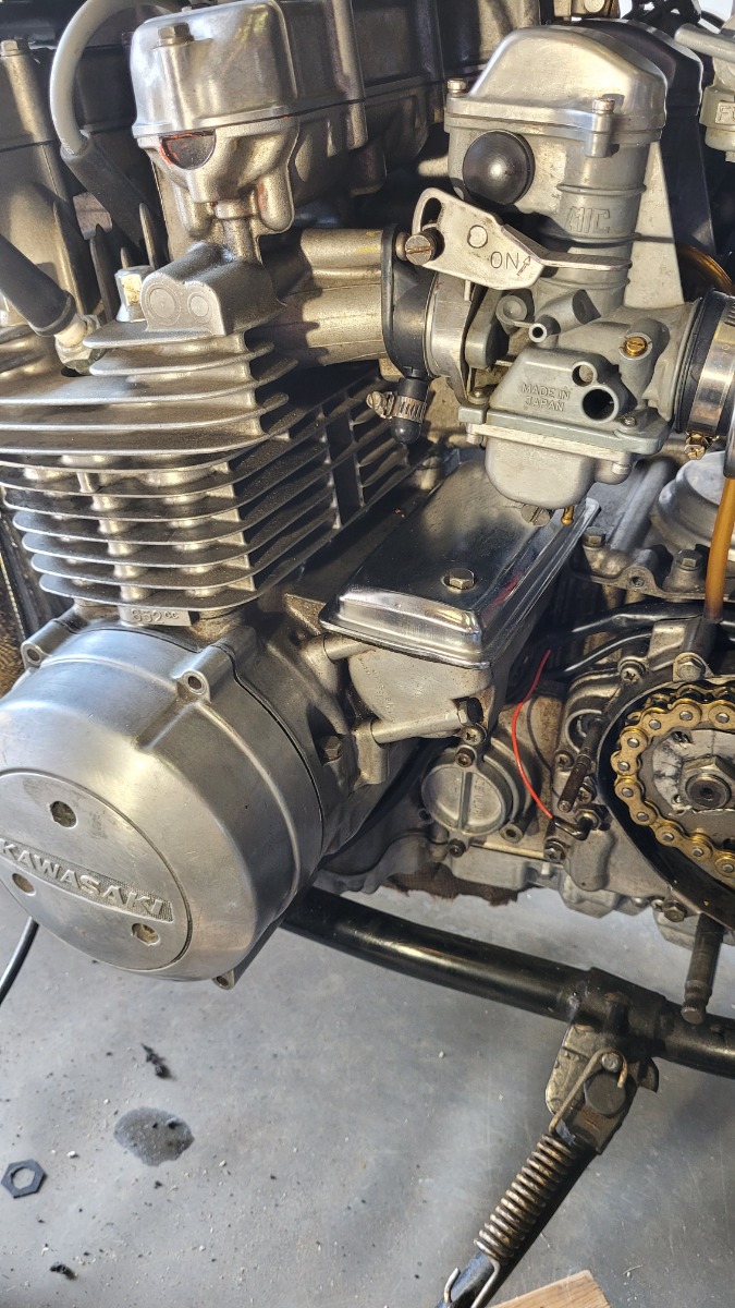

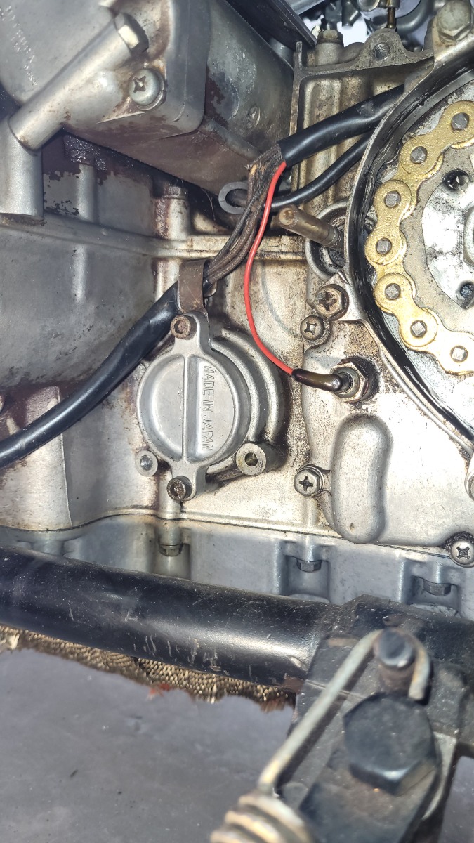

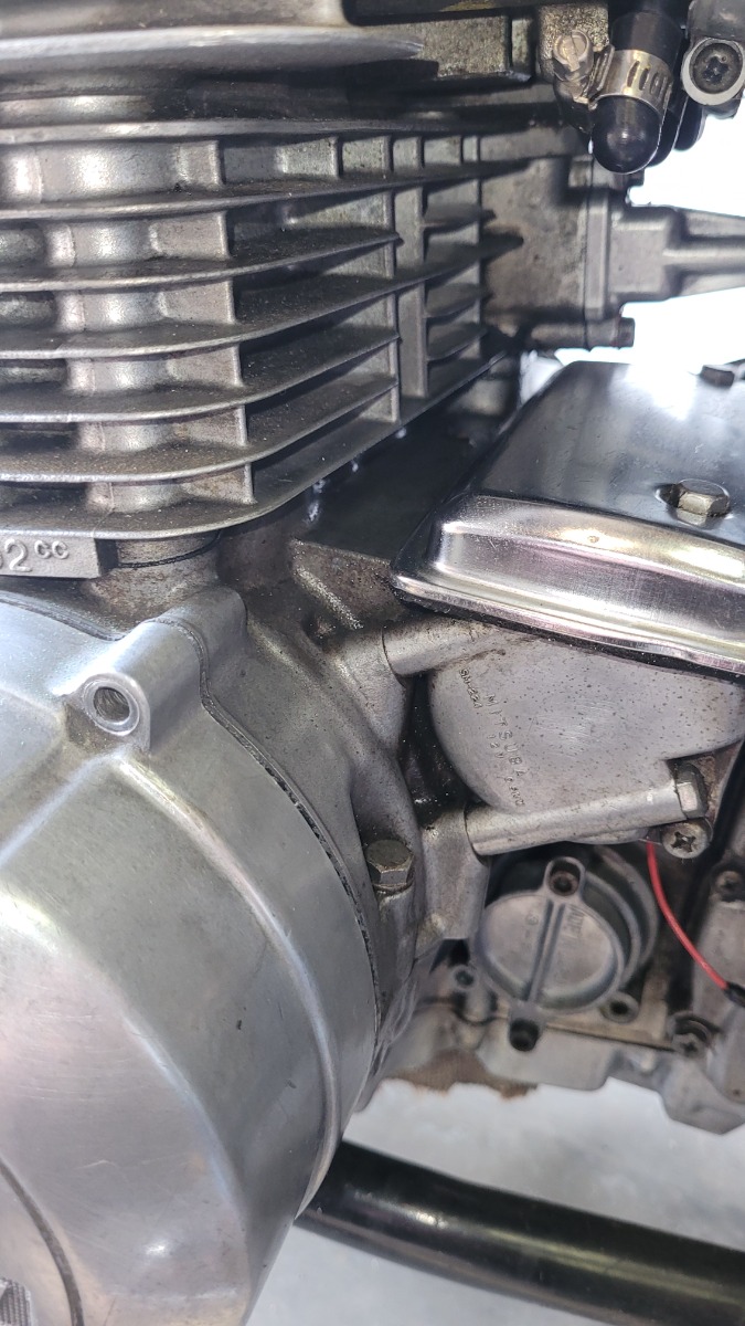

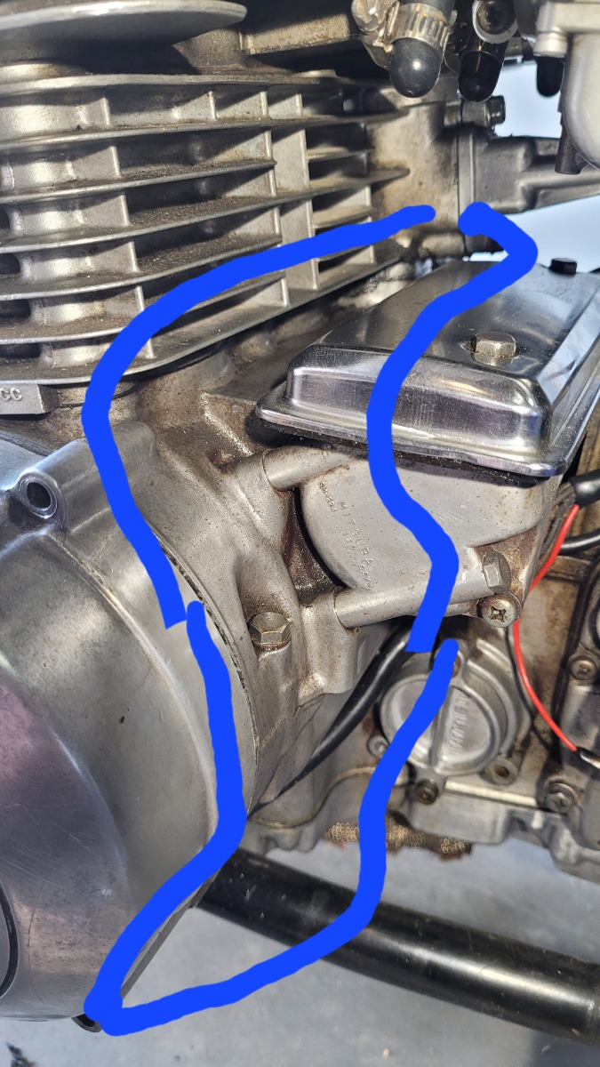

I'm looking to get Help on diagnosing this leak. It appears to be coming from the rear of the engine. I am assuming it's a seal. However I don't know which seal that It is.Does anyone have experience with this sort of weak?

Degrease and dry area. Spray foot powder all around the affected area. Start engine and watch closely for leak source.

Good idea, I'll give it a go
