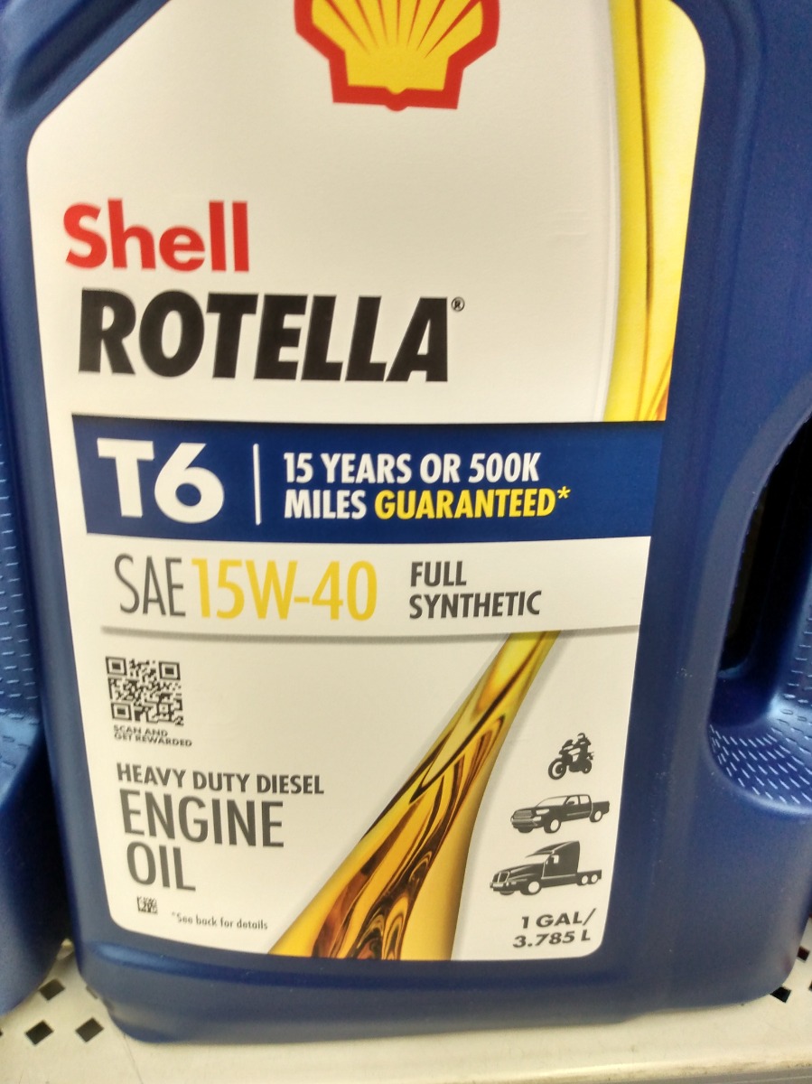

Re: Rotella is officaly a motorcycle oil
20 Sep 2023 17:41
T6 is also available in a 15w option if that is your preference. Coincidently I have a jug with a tractor, truck and a semi -truck on the front. Good stuff. Priced right. I run the 15w for the 3 riding seasons in the midwest USA.
20 Sep 2023 18:46Oops! Maybe I should have looked at the first post in this thread? Ha ha. My bad.T6 is also available in a 15w option if that is your preference. Coincidently I have a jug with a tractor, truck and a semi -truck on the front. Good stuff. Priced right. I run the 15w for the 3 riding seasons in the midwest USA.
T6 used to be 5W-40 only. It's good to see that expanded. To be honest, though, 5W-40 is, arguably, better oil. It will flow through the engine more easily on a cold start, and protect just as well at high temp.
