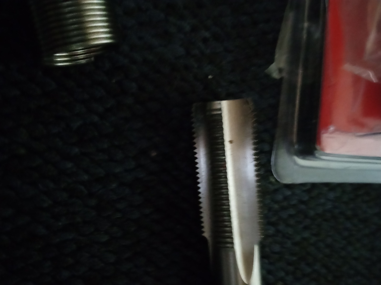

Pic of the tap?

Re: Heli-coil kit for stripped spark plug hole
12 Sep 2023 21:54
DO NOT use a helicoil for a plug thread. The correct insert for that application is a TIMESERT.
Similar to a helicoil but solid with a flange on the outer face to stop it accidently screwing into the combustion chamber when putting the plug in.

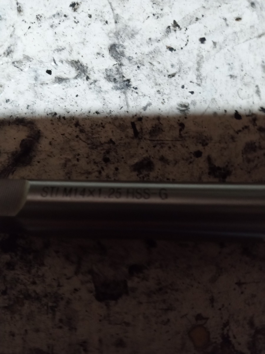

Oh wow I didn't even realize that very well could happen. Good call Warren! Know anywhere I can get just one time-cert? Maybe NAPA will sell me one of their inserts. Does the time-cert need to be long reach M14x1.25x19 or will this protrude into cylinder?

Might seem like a stupid question but what size is that plug, it looks kind of small in your hand against the coil ? (I assume this was in your KZ ?)
13 Sep 2023 10:59
If you use it be careful you follow the hole exactly. With the Timeserts unless it has a leading tap you can go on an angle causing a valve rubbing on the plug electrode.
Stay away from the OEM brand inserts. I tried the one without the leading tap that would follow the plug threads.
I then found one with the leading tap but the damage was already done.
They have a knurled top edge that has to be expanded with a tool that comes with the kit. Not good and the insert would back out with the plug.
In trouble I ordered the larger Timeserts and the expanding tool to use once it was done. They are still loose and I will have to remove the head to fix them.
I suspect the coils you show will compress to fit the threads. I found the valve seat shoulders are very close to the plug threads so I doubt the Helicoil would go past them. The good thing about the Timeserts is they have a shoulder that prevents them from going too far in.
I wish I had used a Helicoil first and RODE THE PISS OUT OF IT to this day.
