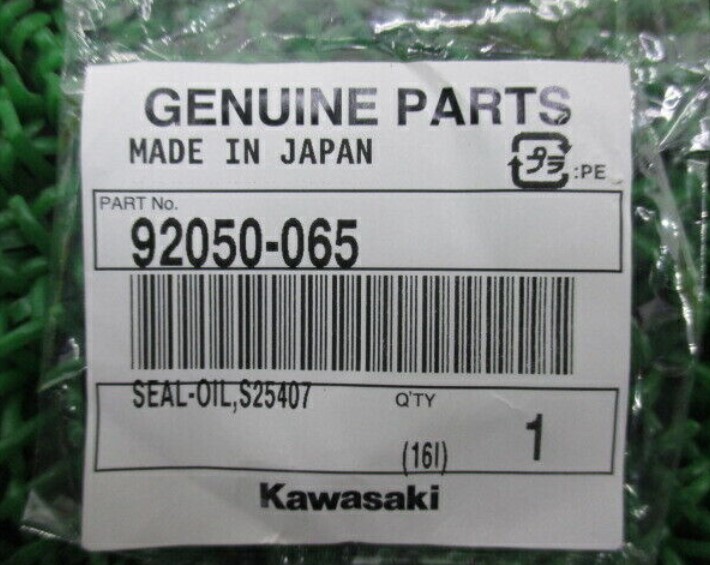

eBay has seals
PN 92050-065
PN 92050-065

11 Sep 2023 15:22How did you come up with the seal size? Did you pull an old seal out of a cover and measure it?
- Posts: 6878
- Thanks: 4330
Re: KZ400H Oil Seal Kit Alternatives?
11 Sep 2023 16:13Generally speaking the number on the seal ( not the OE part number) is the ID-OD-depth
- Posts: 8205
- Thanks: 3577
11 Sep 2023 16:31
Looking at photos on ebay of seals, I don't see any numbers. The Kawasaki label DOES provide this info, though. That's nice!

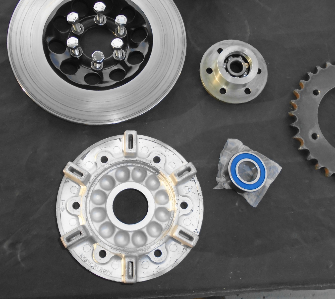

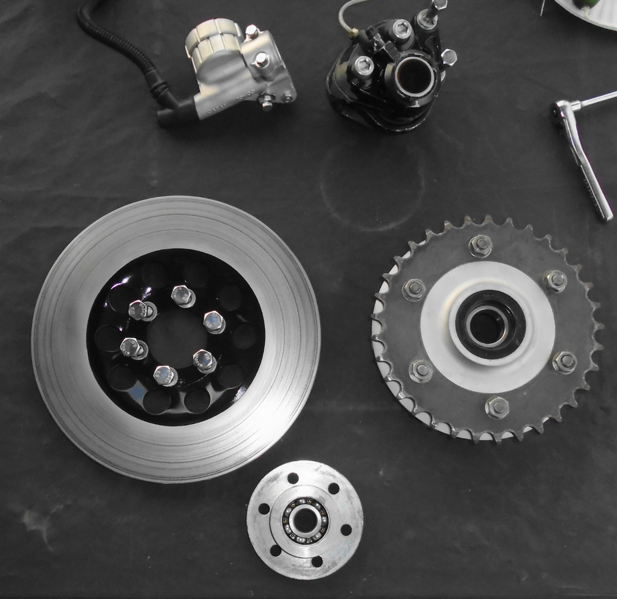

I was just there to get a M #206 bearing! So common in Industry.
62mm x 30mm x 16. (2 0 6 )
I went for a 76 KZ900 LTD rear carrier.
Cash account $9.79.
Just Cruisin" thru the threads here?
Anyone need an LTD - 1976 Only, Morris Mag?
[/attachment]
Cash account $9.79.
[/attachment]
