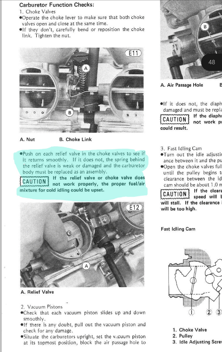

I never seen this.
You have spring loaded doors in your choke plate.
Double check they are closing after they are pushed open.

Also be sure that the relief flaps open easily, and that one or more of them have not come loose and gotten sucked into the engine.
