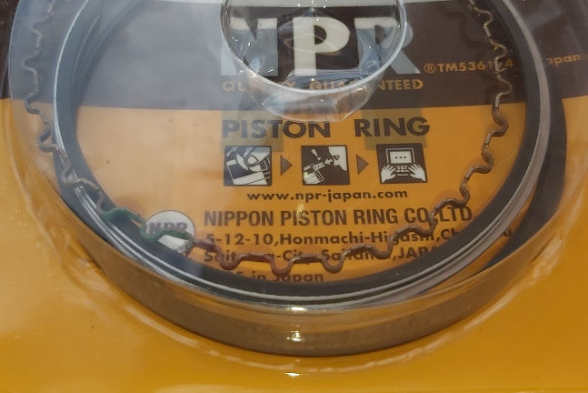

Makes sense, thankyou for your input. It seems there are some nippon (non OEM standard rings with that part number), their quality looks / feels good in bore. I was just curious as to why Kawasaki has two different OEM part numbers for rings that do the same ?

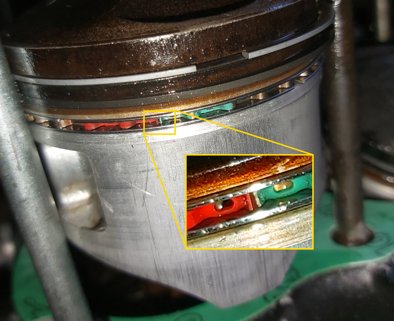

I recently refreshed the top end of my Lawson "Tribute" using those NIPPON rings.
I really liked the green / red colored oil-ring expander tips, which help ensure propper installation.
H.
H.

I bought a set of these, Quality looks as good as OEM
