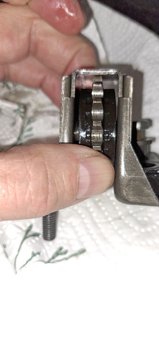

It is the primary drive sprocket not the camchainsproket it looks like a pinbearing in the first photo i agree. The rubber wheel in the middle of camchain tunnel i have remowed before the pick was taken it was hard as stone.Maybe the black pieces i found is from one of the "rubber" wheels ? i will not check that now because im eating a cake and watching a movie

Update stopped eating cake and took a closer look on the sprockets and rollers. The sprocket wheel that is in left on piicture is very wiggely and i can push the inner needle bearing out with fingers. The sprocket that is sitting on top of the camchain tensioner bar is firm but will replace it .The rubberwheels is hard as bone and the small square rubberdampers is like stones.
The top idler is total lose can wiggle it in any direction and also up and down and the rubber dampers on that is like stones too

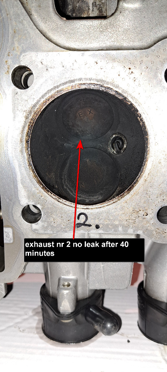

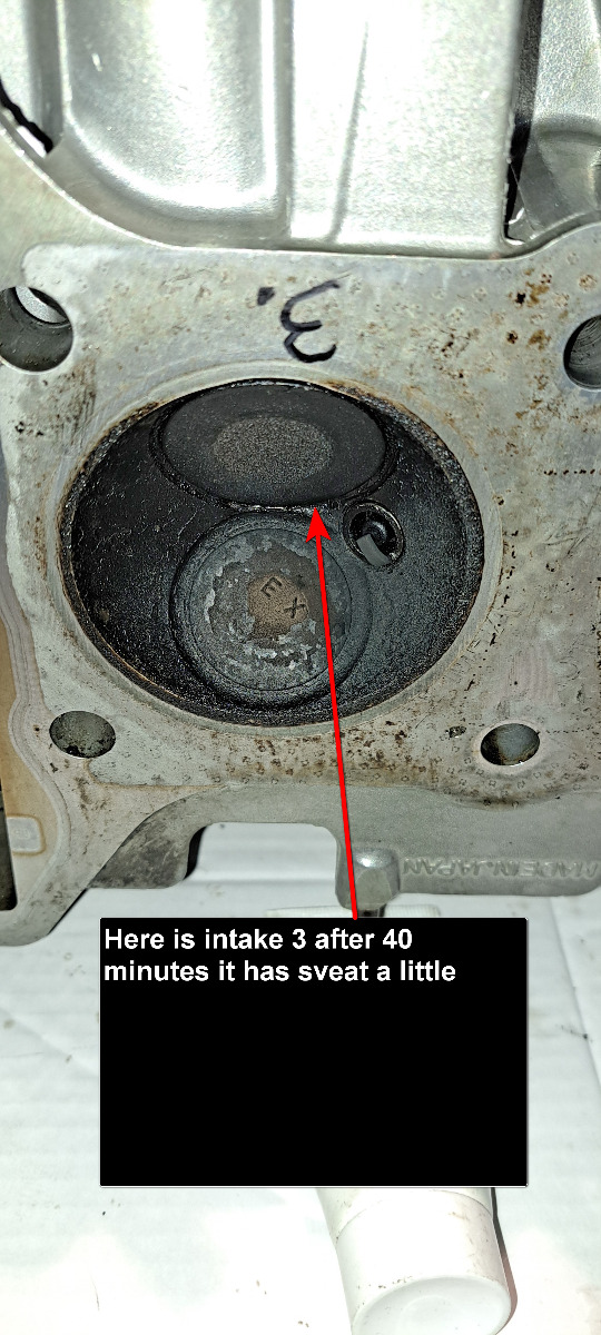

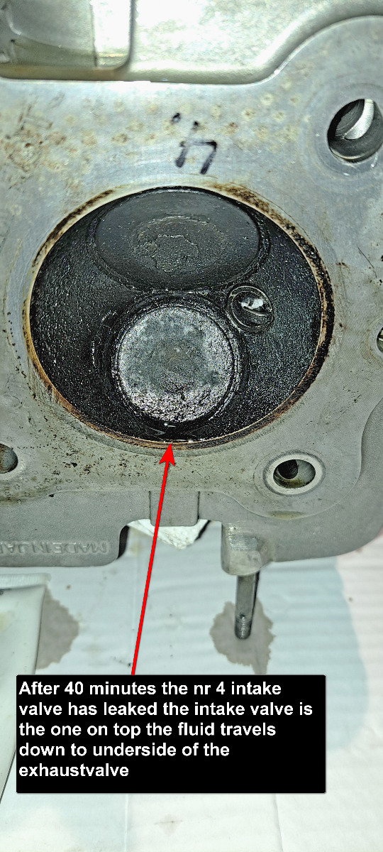

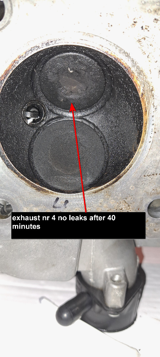

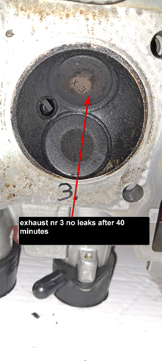

Yesterday started to test the valves before i start clean off the carbon just to see if they leak.
Tested by placing the head so the exhaustports face upward and then fill the ports with solvent an let it sit
for a while.After that i tested the intake valves the same way. I found this method is very good to see if the
valves leak. I have earlier tested by filling the combustion cambers with solvent ,but then will have to wait
for long time to see if a valve leaks and then the fluid evaporate
if its not a major leak.
The valves was very good only nr 4 intake had a small leak and some had a little sveating, but that is good after 40 minutes of standing filled with solvent. I will next take them out and just check if the valve seat and valve face width is in spec.if not i will cut the seats.Also will check the valvestem for runout and if the valveguide is in spec.

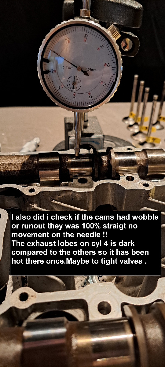

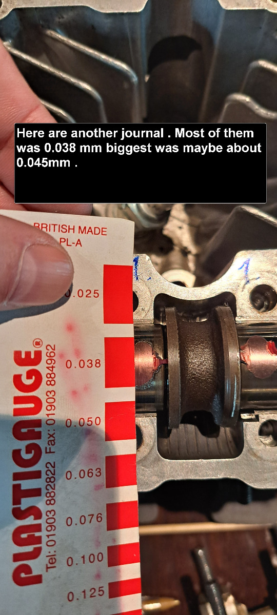

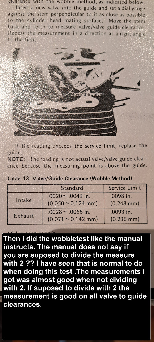

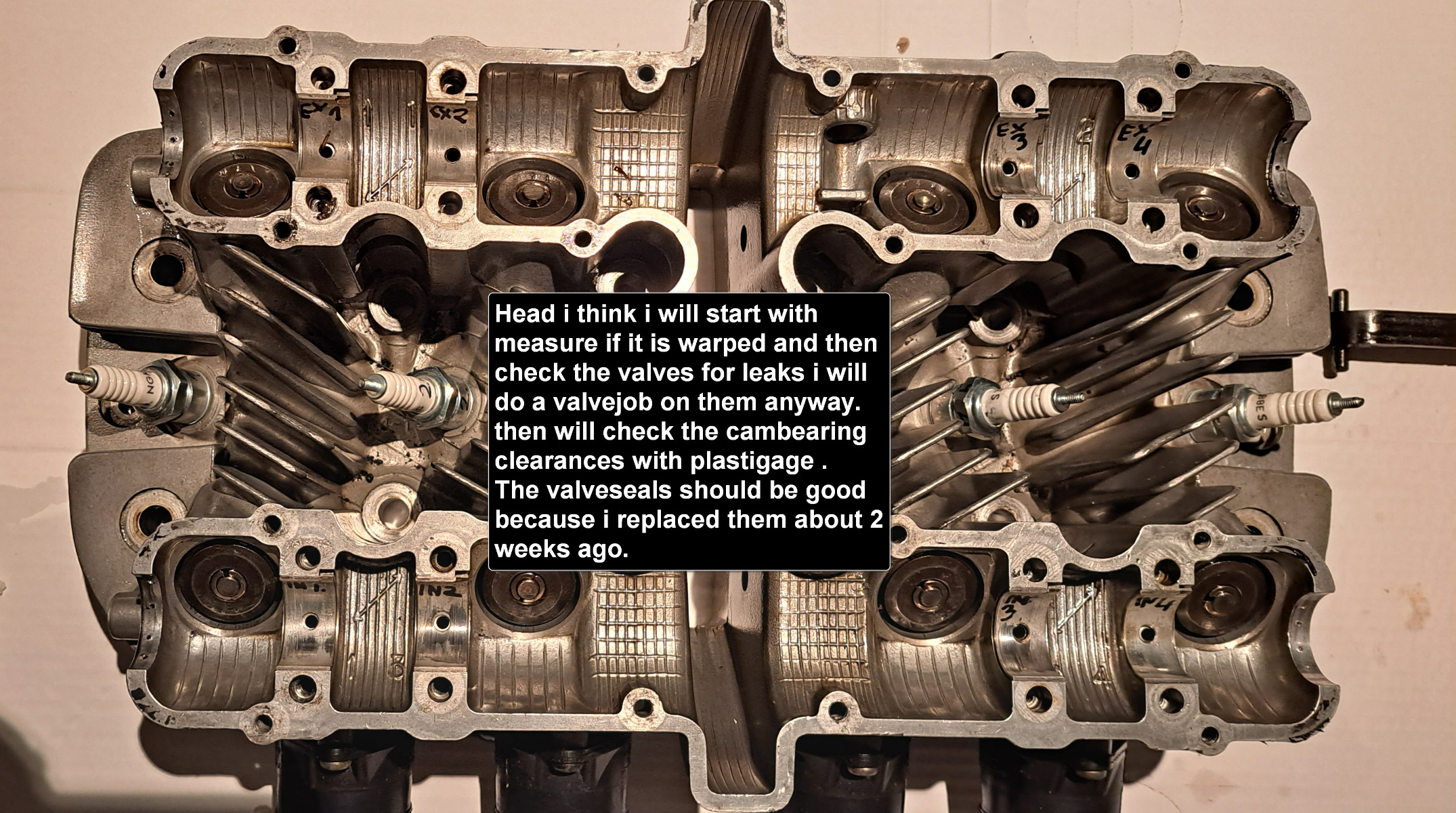

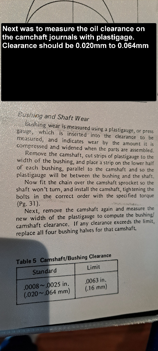

.since last time i have done some more work on the head. Measured the head for warp and it was not warped .Cleaned valves and measured them for runout and valvestem thickness.
also done the wobbletest that i dont think is so acurate.The valves look very god and i dont think it is too long since someone refreshed them.The valveface width looks good i have not measured that yet,but no serius pitting .Maybe it is enough just to lap them .Today i have measured the camchafts for runout and also the
oilclearance on the journals with plastigauge. all is in spec so that is good.Next is to measure the springs
and lap valves
