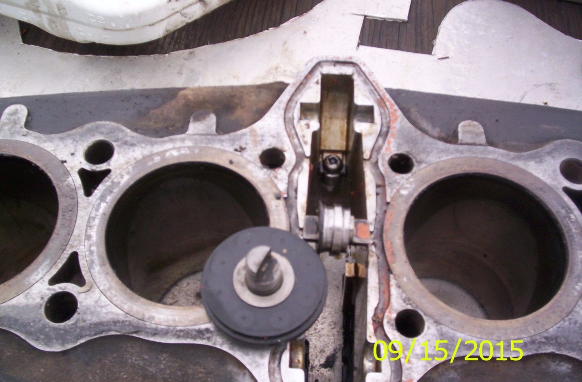

Are you sure the rollers aren't coming apart?
