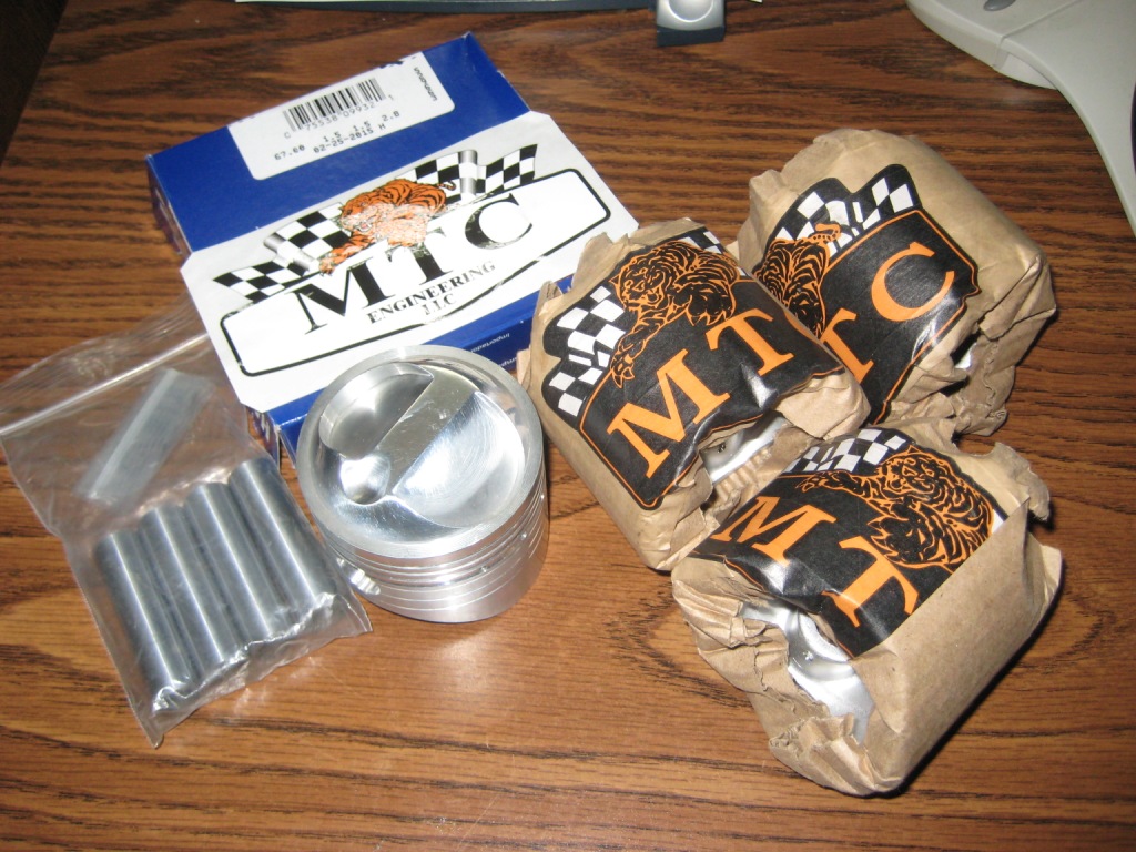

17 Aug 2023 11:35MTC use to offer a 67mm = 761cc kit (+1mm) and a 68mm = 784cc kit (+2mm) they do sometimes come up on Ebay and here (bought a NOS 761mm kit off a member on here 3 years ago)I have a Wiseco 810 kit in my garage, but I've held off because my stock engine is running great, and I don't like the fact that the liners will be so thin. I wish there was a 2mm over kit, or even a 1mm kit, which will leave the liners thicker. Maybe this a moot, and just something that sticks, needlessly, in my head, but i'd prefer a kit that left the liners thicker.

17 Aug 2023 18:08MTC use to offer a 67mm = 761cc kit (+1mm) and a 68mm = 784cc kit (+2mm) they do sometimes come up on Ebay and here (bought a NOS 761mm kit off a member on here 3 years ago)I have a Wiseco 810 kit in my garage, but I've held off because my stock engine is running great, and I don't like the fact that the liners will be so thin. I wish there was a 2mm over kit, or even a 1mm kit, which will leave the liners thicker. Maybe this a moot, and just something that sticks, needlessly, in my head, but i'd prefer a kit that left the liners thicker.
Do you still have that 761cc kit?

18 Aug 2023 12:30 - 18 Aug 2023 12:32Yes, I have a 750 barrel bored and honed to take it, its going in a fuel injected project I have in the works. I got a excellent deal on here from a member in New Mexico, it was just the pistons, rings, and pins.MTC use to offer a 67mm = 761cc kit (+1mm) and a 68mm = 784cc kit (+2mm) they do sometimes come up on Ebay and here (bought a NOS 761mm kit off a member on here 3 years ago)I have a Wiseco 810 kit in my garage, but I've held off because my stock engine is running great, and I don't like the fact that the liners will be so thin. I wish there was a 2mm over kit, or even a 1mm kit, which will leave the liners thicker. Maybe this a moot, and just something that sticks, needlessly, in my head, but i'd prefer a kit that left the liners thicker.
I always recommend MTC over Wiseco as they are made from better materials. My other go too would be JE.
