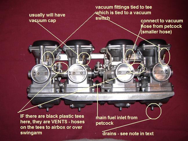

It's currently disconnected because I could not find where it plugs into so I just capped it. Do you know where it should be connected? I'll just pull the tank and reconnect it. Thanks

Thank you for the diagram Warren3200GT. This will be very useful

Even connected to only one of the carb vaccuum nipples, any one available, would make it work. Preferable though, get two at least.

Is not two nippels for vent and one for vacuum?

14 Aug 2023 16:17The carburetors pictured above each have a vacuum port (nipple). On U.S. bikes, two of them are connected to the Clean Air System, which reduces exhaust emissions. Most folks delete the system and cover the ports with rubber caps designed especially for that purpose. One of the remaining vacuum ports is connected to the fuel valve (petcock) on the fuel tank. The last remaining vacuum port is capped with a rubber plug. All four of those ports are necessary to synchronizing the carburetors.Is not two nippels for vent and one for vacuum?
Every carburetor must have a fuel bowl vent. Sometimes they are individual hoses, sometimes (as above) two carburetors share a vent, so there will be only two vent hoses, one for numbers one and two, the other vent hose is for three and four.
