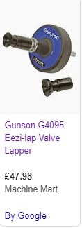

I can never get those wooden lapping sticks to work. the rubber suction cup always slides off the valve. Is there a better tool?

02 Aug 2023 09:36 - 02 Aug 2023 09:38There are drill attachments like the below that give the alternating action required through the internal gears, however I have managed with a wooden stick for the last 40 years (cleanliness and having the tool central is the key)I can never get those wooden lapping sticks to work. the rubber suction cup always slides off the valve. Is there a better tool?
