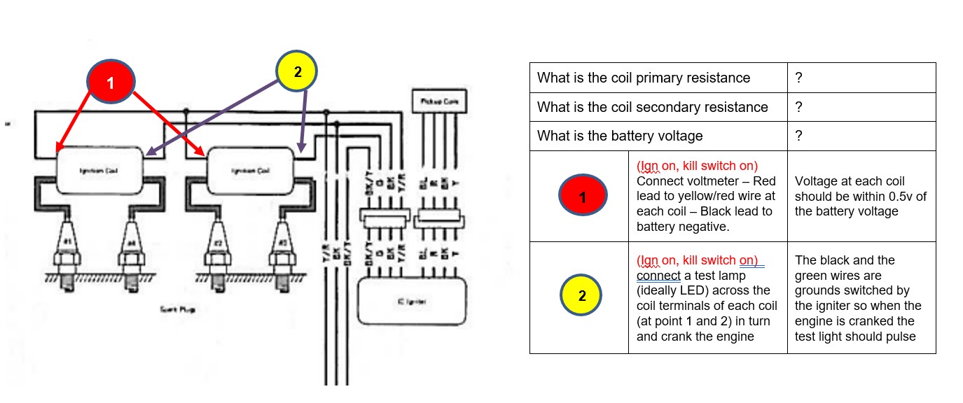

Re: Running on 2 cylinders
27 Jul 2023 01:28 - 27 Jul 2023 01:28It's not clear what you are testing here and how? I would suggest you follow the below and let me know what results you getHey guys, I've done some research but I'd like some fresh eyes as I'm frustrated. 83 kz550m1. Complete fresh rebuild on carbs and had the valve cover off to check valve lash prior to the issue. It's misfiring for sure. I have yet to even sync the carbs and adjust air screws but I did do a visual syncing the throttle plates. When is running and i pull the plug wires off one at a time, cylinders 1 and 4 change the rpm very slightly but I am getting spark. Plug wires 2 and 3 will kill the engine when pulled off. I checked cylinder 1 and 2 plugs and 1 is wet while 2 is dry. With the good spark coming from one coil and the weak coming from the other, I'm thinking I've got a bad coil but resistance measurements are the same on both.
And I check for voltage at the coil power and ground with key on and the ones running to the "good" coil have good power but the green wire isn't grounded? The "bad" coil has battery voltage. So that's backwards off what I thought I would have found. Any insight would be appreciated
