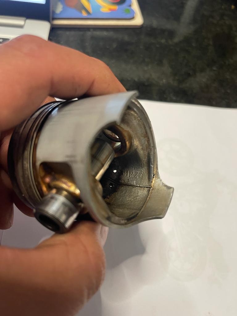

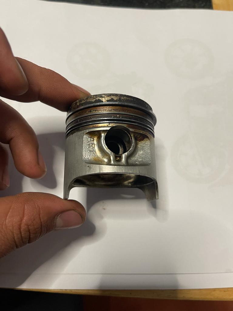

I have a bit of problem, I have brought a Z400-J2 which is a four cylinder, they made the J1,J2,J3 for the European market. My problem is that cylinder number #1 is seized and when it was stored the previous owner had left the spark plug out, resulting in the piston seizing in the cylinder, I have a funny feeling I'm going to need a new set of cylinder and a piston and rings, only problem is i cant find any part numbers.
Does anyone have a printout or is willing to scan the parts catalouge, or know if what parts I need?
I can only see 4 + on the inside on one side and 1227 with possibly a 0 or o beforehand but it just looks like a casting mark if that helps.

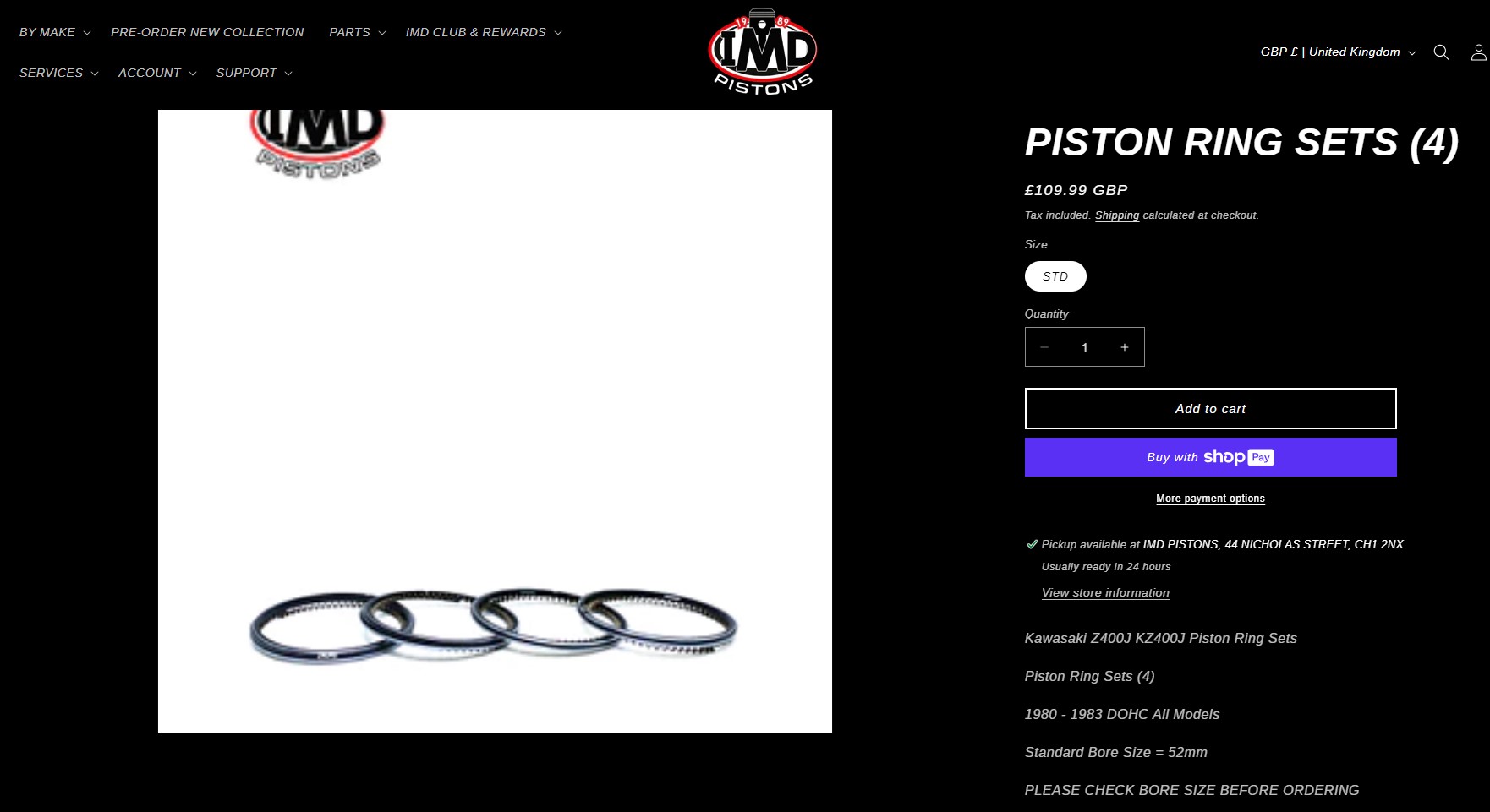

What condition is the cylinder in ? if you can get away with honing then IMD do a ring set for it - oversized pistons seem tricky to find !

OK one of the sites selling a part catalogue happened to show a page which shows part numbers for standard, and both next over bore sizes . It also shows part numbers for the 3 different ring sets.
13001-1029 piston standard
13029-1011 piston .020 oversize
13027-1012 piston .040 oversize
Here is the ebay site ebay de itm/394763403810

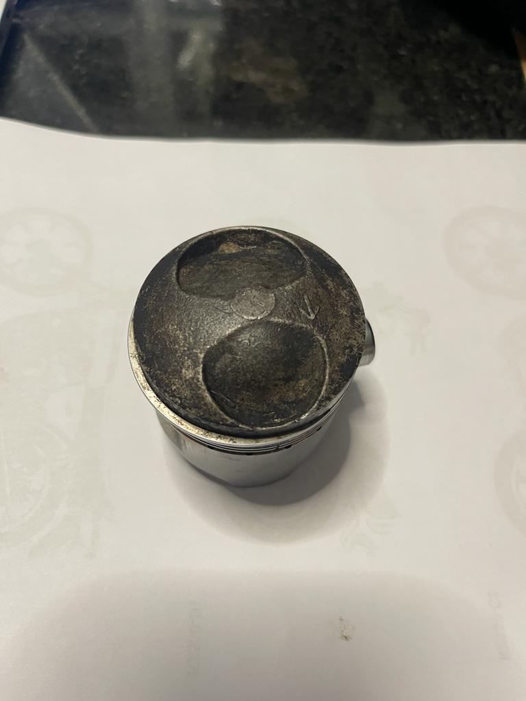

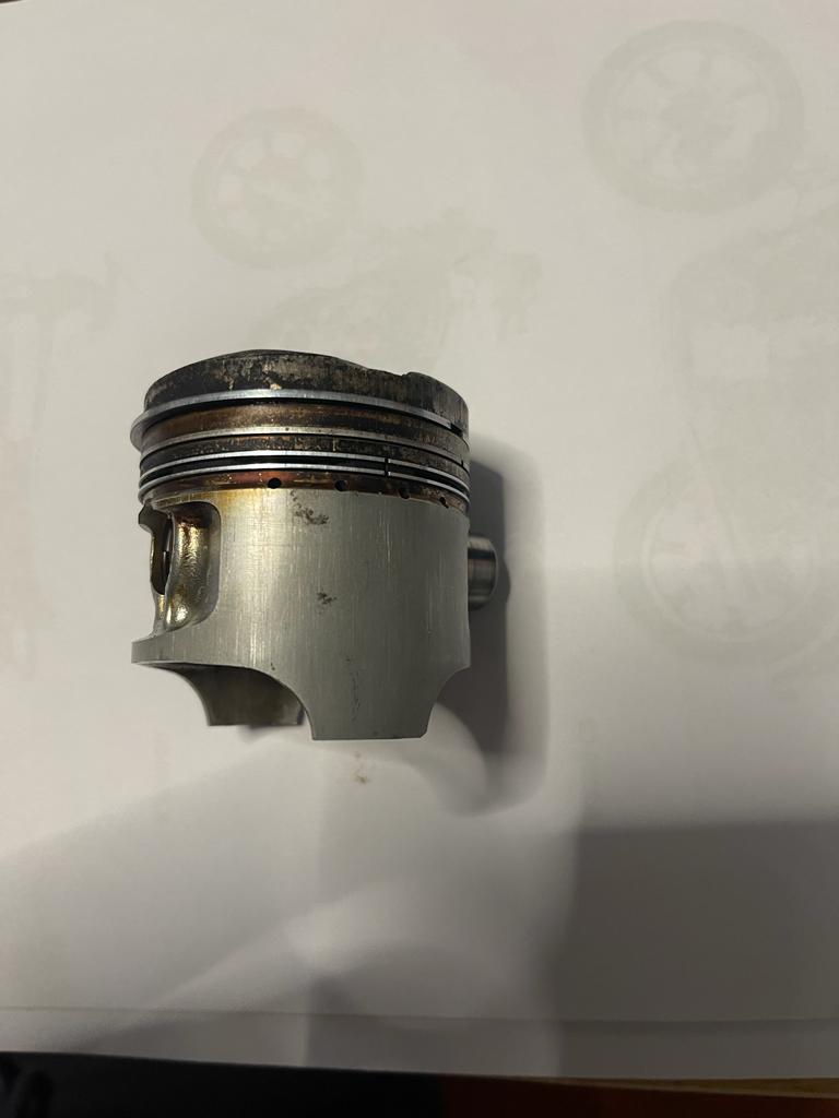

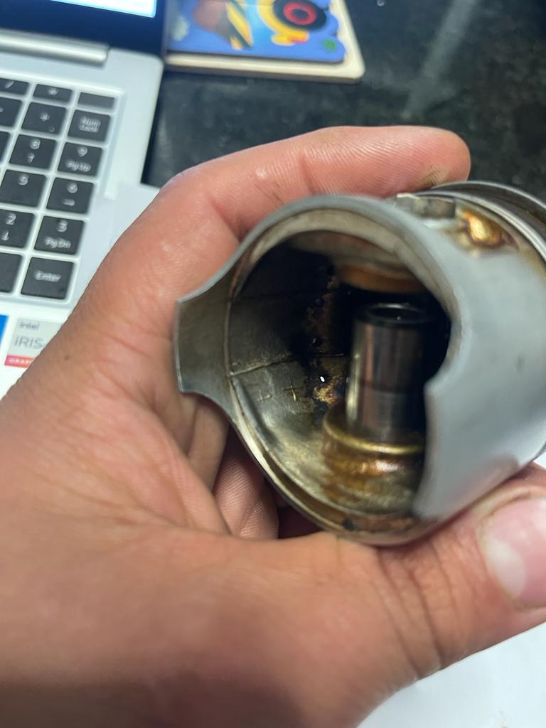

Thank you for everyone'ss replies. I took another stab at the ye old cylinders today and managed to get the stuck piston out. It definitely needed some persuading for sure! Heat, penetrating spray, vingar and lotttssss more heat along with an almighty wack with a hammer and a big socket extension and she eventually broke free.
After taking my honing stones to the conflicting cylinder and touching the others up, i have now come to the realisation that that cylindar is as much use as a chocolate fireguard!
After lots of head scratching and grunting, I have have 4 options.
Option 1 - Find one NOS standard piston (provided the others clean up okay and I can get the rings out) then install three old pistons and one new piston with a set of new rings for all. Then get another 2nd hand cylinder as the current one is junk as S.T.D size won't fit , then hope the newer cylinders clean up okay (storage marks/ corrosion on pictures) and accept the new NOS standard and older pistons and rings but I can only currently find 2 new standard pistons.
Option 2 - Get the current cylinder rebored to 0.040 as 0.020 i don't think will be enough as the corrosion is still bad after a heavy hone. Then get 0.040 O/S pistons. which i can find 4 off and a set of 0.040 O/S rings.
Option 3 - Get the other 2nd had cylinder and rebore that one to 0.040 and slap the new 0.040 O/S pistons and rings in.
Option 4 - Find a 550 engine and relative bits and install that (This would mean it's no longer a true 400J )
I would be glad to hear everyone's thoughts and opinions.
I think I have got some work cut out for me!!
Many Thanks in advance

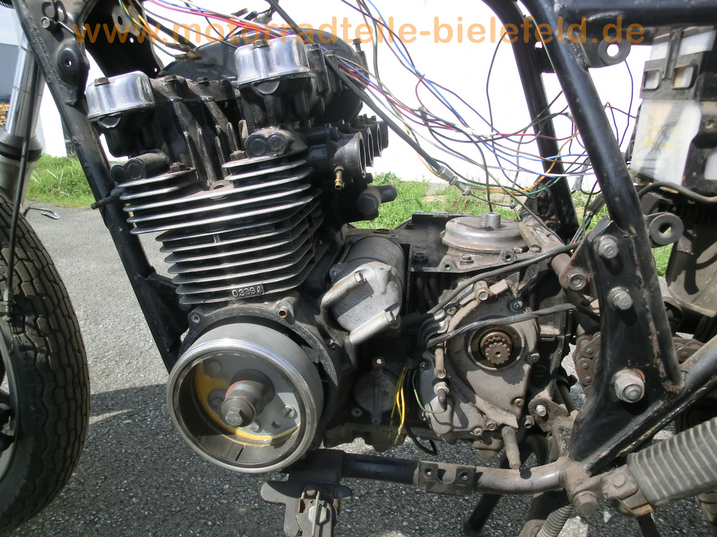

He sales a lot of KZ 400 J parts bikes
motorradteile-bielefeld.de/foto-galerie-kawasaki/
motorradteile-bielefeld.de/galerie/thumbnails.php?album=1314
motorradteile-bielefeld.de/galerie/thumb...php?album=903&page=1
motorradteile-bielefeld.de/galerie/thumb...php?album=992&page=1
