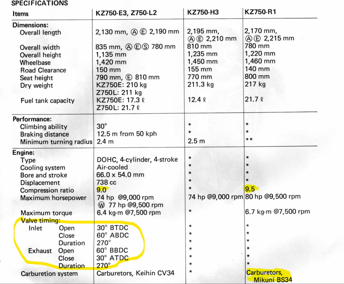

The cams in question are claimed to be from a 1982 GPz750. As I understand it, those cams have the same lift and duration as the regular 750 cams, only they don't have a tach drive.

The fsm says the GPZ makes a few more horsepower than the other versions. If the cams are the same, I wonder where the other ponies came from. Could the BS34s really make more power then the Keihins?

19 Jul 2023 17:07The fsm says the GPZ makes a few more horsepower than the other versions. If the cams are the same, I wonder where the other ponies came from. Could the BS34s really make more power then the Keihins?
GPz has more compression, better flowing carbs, and the bath tub head. And I'm not sure, but I think the exhaust flows better.

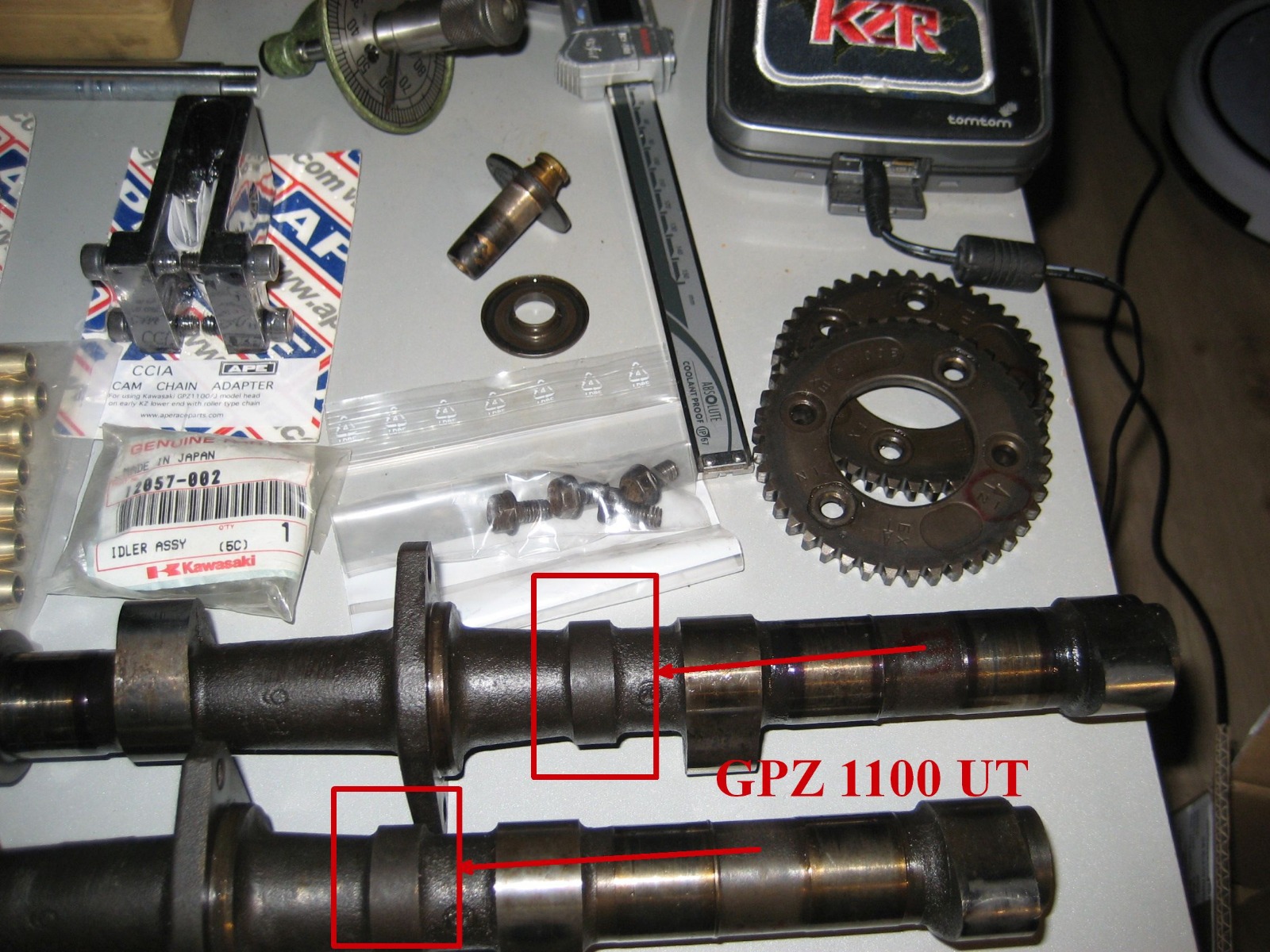

The Uni Tracks got the bigger cams except for the '82 GPz1100, which had 8 degrees more duration than the '81 model that has standard 'J' cams.
I do not know what the difference in lift is.

Indeed. If you take a look at the 1983-85 supplement in the back of the fsm, the specs clearly show a change in 1983, compared to the numbers posted by Nessism above. See pages 343 and 358, for example.
