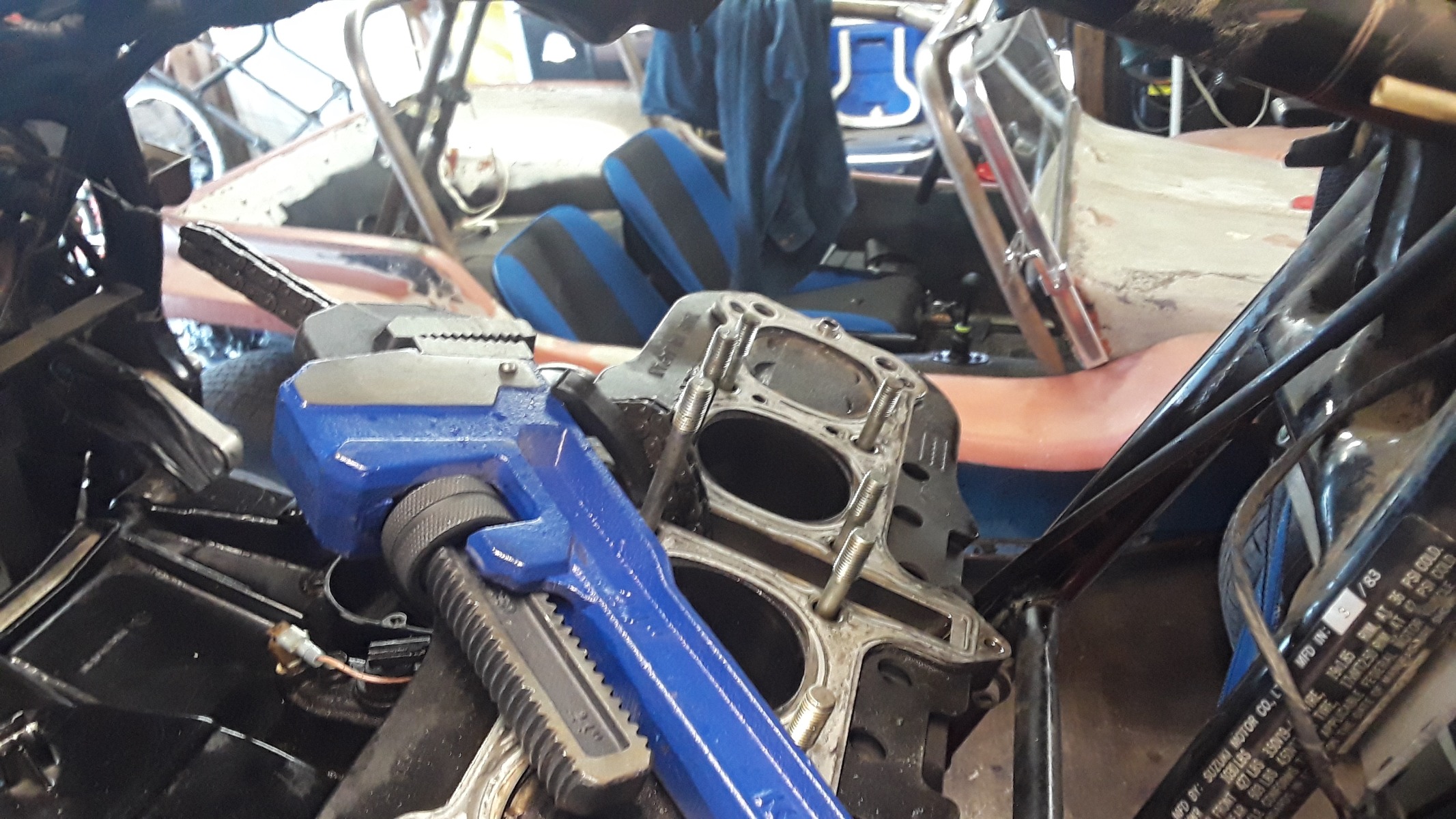

FWIW I used a 36" pipe wrench to get those studs out, but I didn't care about damaging them. "Double nutting" them wasn't budging some of them. They were replaced by APE studs
