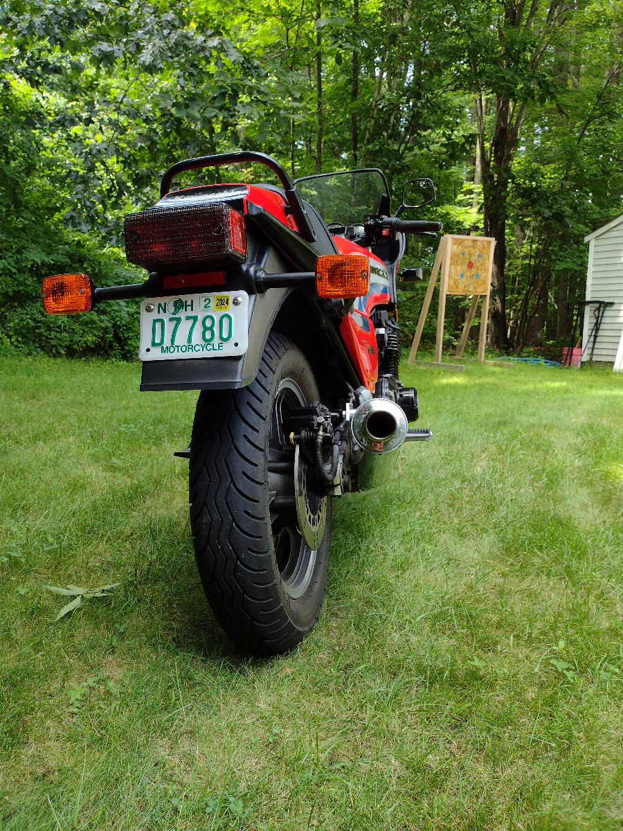

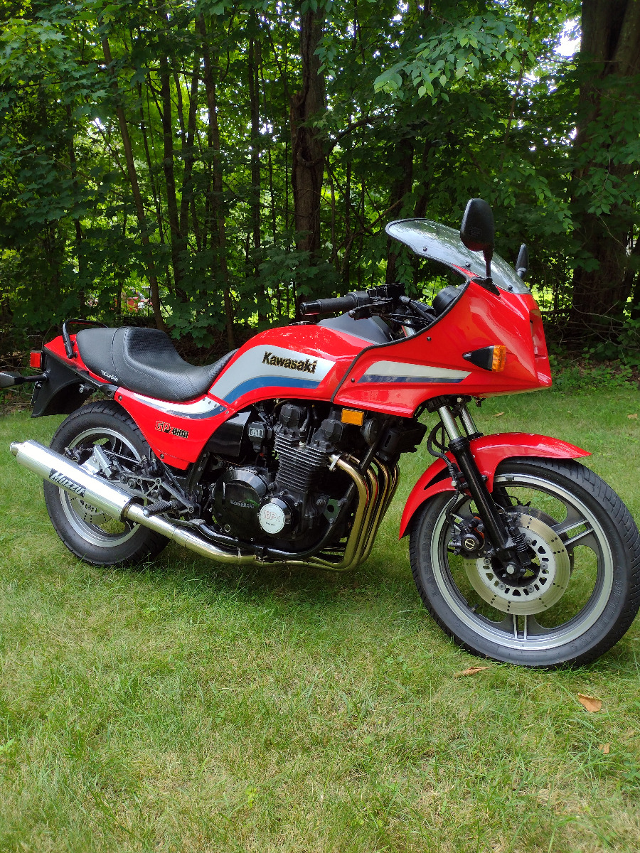

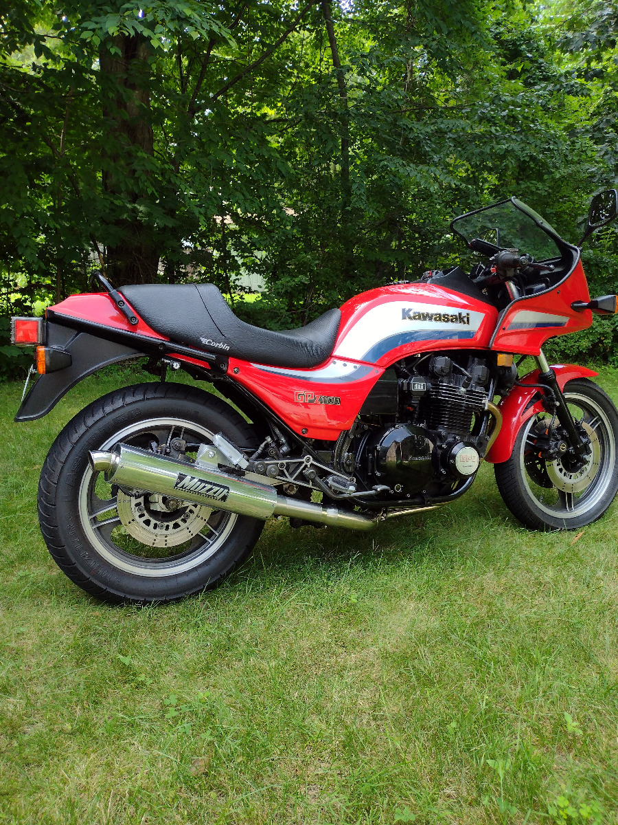

Wanted to remove my undamaged OEM exhaust as I need to research somebody local that can blast and coat my header down pipes as the black chrome is getting pretty badly rusted.
There's NOT a lot of exhaust choices for the air cooled Uni-Track GPz's . I ended up buying a Delkevic header and a used Ebay Muzzy muffler and mid pipe off a Kawi ZX636 . It's real tough to find older 1990's Muzzy / D&D / Yoshi round mufflers as 95% of them used are total road rashed / crashed junk. The used Muzzy I bought was not rashed but very oxidized and had a lot of light scratches. I was able to sand and polish out 90% of all the defects. Looks excellent. The fit of the Akrapovic header is outstanding and I have total easy access to the oil filter cover .
