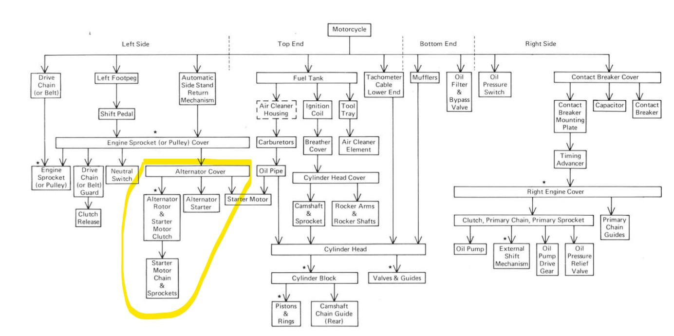

Just wondering about this... Why doesn't the KZ440 engine have a left hand side crankshaft seal?

The oiling system is designed to lubricate/cool the starter clutch and starter motor drive system. This means that there is no need to seal the crank on the LH side.
