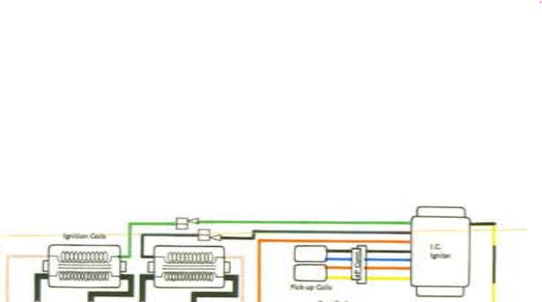

Are you running the Dyna S directly to the coils or are you still using the stock exciter?
I have the same bike. Several years ago I had problems with two cylinders not running. It was an intermittent issue that made it hard to trace. I eventually concluded it was either the exciter or the stock ignition so I switched to Dyna S and 4 ohm coils. I stripped out the exciter as well and wired the Dyna S ignition directly to the Dyna coils.

I suspect the exciter is the problem. You should be able to wire your ignition to your coils directly. You will need to follow the Dyna directions. I don't like the coupler they provide for providing power to the ignition (red wire) so I just extend it and plug into the spare brown double female receptor near the headlight.l

I'm on vacation right now so I don't have access to my bike to take photos. But from memory I think there are four wires going into and out of the exciter but only three wires coming from a Dyna S ignition. To wire directly to the coils there should be a green and a black wire. One goes to one coil and the other goes to the other coil. Just match the colours. The third wire is the red one that needs to go to a hot wire. I use the spare brown but you could tap into your red starter wire as well.

Re: Will not start
11 Jul 2023 06:06 - 11 Jul 2023 06:07Black and Green = Coil triggersI'm on vacation right now so I don't have access to my bike to take photos. But from memory I think there are four wires going into and out of the exciter but only three wires coming from a Dyna S ignition. To wire directly to the coils there should be a green and a black wire. One goes to one coil and the other goes to the other coil. Just match the colours. The third wire is the red one that needs to go to a hot wire. I use the spare brown but you could tap into your red starter wire as well.
Red = Ign live
Black/yellow = Ground
PS: did you ever check the supply voltage at the coils ?
