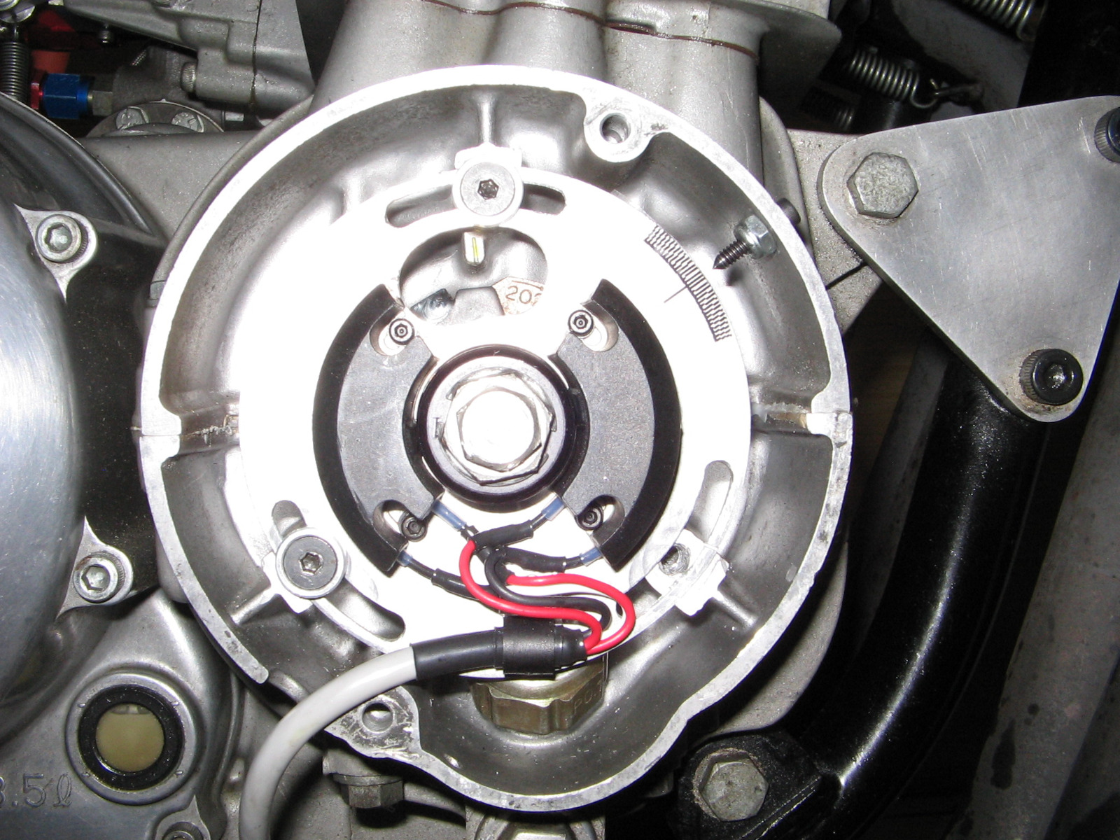

I am unaware of a provision on the stock ignition setup where the actual degree BTDC timing can be read. It is "factory fixed" at 40 degrees, I do believe.
The Dyna 2000 rotor-scale indicates my engine is currently set at 38 degrees, both statically and with my timing light.

I am unaware of a provision on the stock ignition setup where the actual degree BTDC timing can be read. If you use an adjustable timing light you can dial in the advance you want and use the TDC mark on the advancer. It is "factory fixed" at 40 degrees, I do believe. 40 degrees would be maximum advance at the top end of the advance curve - static or idle would be around 10 degrees
The Dyna 2000 rotor-scale indicates my engine is currently set at 38 degrees, both statically and with my timing light. I'm not familiar with the Dyna 2000 but it will still have an advance curve (map) instead of using weights and springs it uses an electronic map which can be altered (back in the day tuners changed bob weight mass and spring tensions to tune ignition curves)

18 Jul 2023 09:40I do have a adjustable timing light but don't really need it on the 750 street bike. Just slotting for a few degrees each way is not dangerous, you can tune by "ear" but its better to use a timing light. Being able to run advanced or retarded is a bonus, most times its better to dial it back as it runs cooler and starts easier.You could static time it with an LED test light across the coil terminals (ground to switched side) when it loses the ground is when it fires (same as points opening)
Stock ignitions are not setup to run at 40 degrees, that is a race bike setting. Maximum recommended for 2 valve air cooled heads with single plug per cylinder is 38 degrees.
Stock fixed setups are more likely set at 36 degrees or less.
Drag racers remove the springs and weights then weld the advancer in a fixed position (usually 40 degrees) Dyna also sell these fixed rotors that eliminate the advancer, racers often make there own copies utilizing the stock Dyna rotor magnet. The slots on the Dyna back plate are then further enlarged as necessary.
I was able to run 50-55 degrees advanced with a Dyna S setup so I could fire alcohol in my drag bike.
