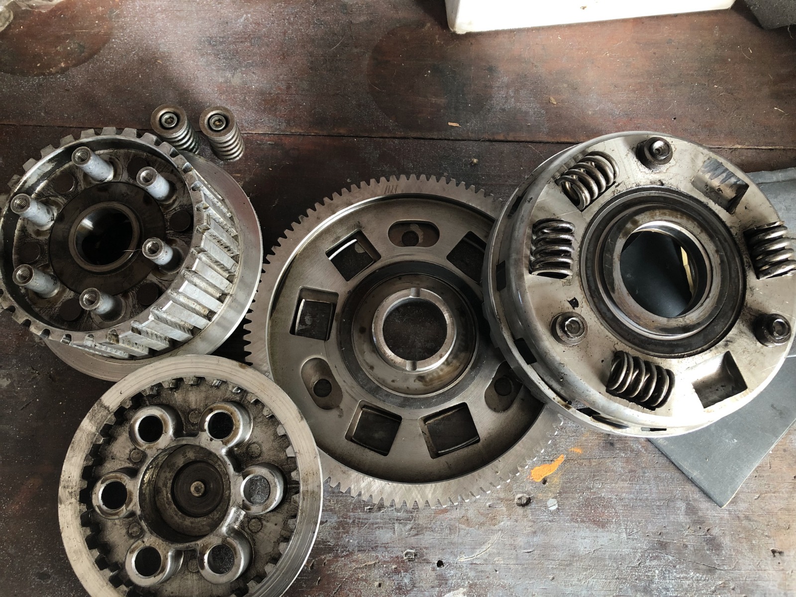

I have a completely disassembled clutch basket here, and I'm almost sure it's from a kz1000 Shaft, will it be worth leaving it in shape for a spare part of my kz1000 A1? It's compatible?
Thank you.

YES!
As a complete unit it will fit ANY Z1 , Z900, Z1000 kickstart type engines.
Some individual parts are different though such as the hub and pressure plate having six springs instead of five so it's of limited use for spares for the non ST/MK2 type clutch.

Thank you very much friends, where do you get the springs and rivets?

03 Jul 2023 12:59 - 03 Jul 2023 13:00APE PERFORMANCE. $95.Thank you very much friends, where do you get the springs and rivets?
KZ Zone - Clutches
Scroll to the bottom of the page.
