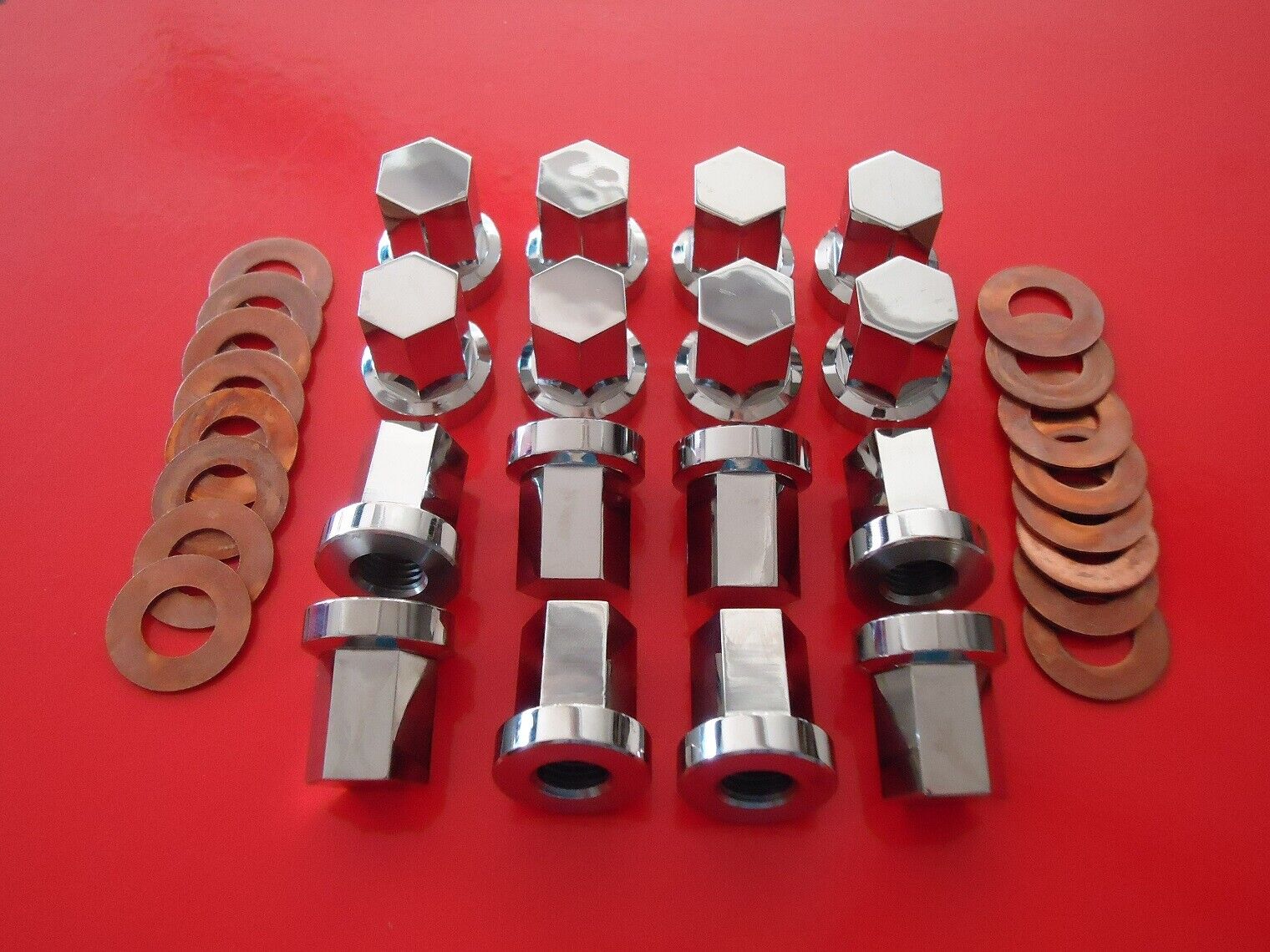

A nice set of polished stainless steel nuts for 4 and 6 cyl. bikes (ebay.com/itm/114286618817 and ebay.com/itm/115429409094)

Do you know why the aftermarket nuts are taller or don't have a top on them?
Because you need the extra height when decking the barrel or cylinder head, a short stock nut will bottom out on the stud.

Saving weight, by having open nut?
