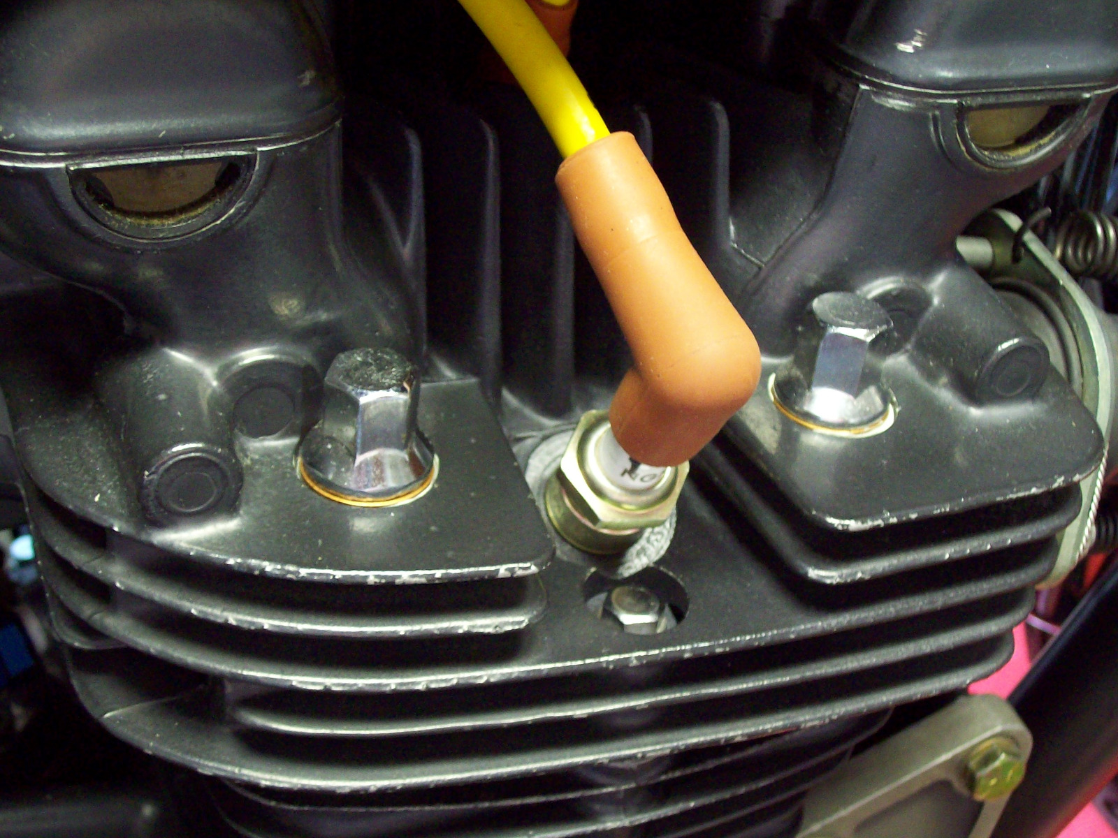

I'm using the stock ones with new copper washers.
