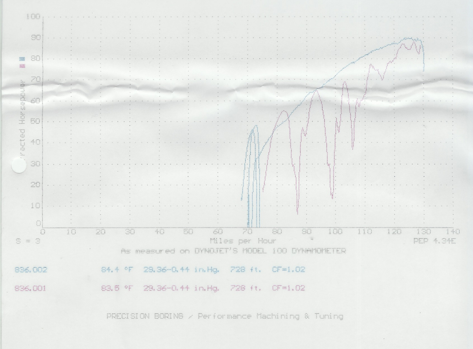

Like I said before, the higher the cranking compression is the more HP potential there will be - pretty simple. This has nothing to do with your aftermarket 10:1 comp pistons, but a lot of other factors such as cam duration and cam timing, combustion chamber volume/piston dome volume, ring seal, etc.
If you go crazy trying to get maximum PSI you will find that pump gas will no longer be useable to keep knock at bay.
You can't quantify PSI with HP on a individual basis, it has to be measured on a Dyno because no two engines are tuned alike.
Dyno's are more plentiful than 20 years ago, one hour booked is pretty reasonable as long as you don't have to make any tuning changes.
Here is one from my KZ650 street bike taken in 2015 :
831cc 10.5:1 comp MTC, big valve head, Stage 3 port, 400 lift WebCams, 33 mm Flatslides = 89 HP at the wheel (second run 836.002)
Stop trying to guess and measure it, its not a lot of $.
