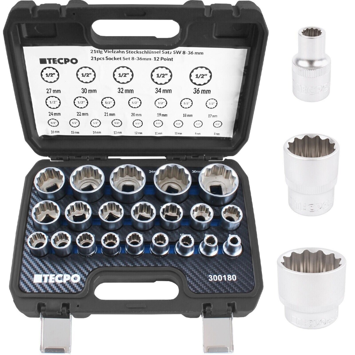

Try to hit it with an outside multi tooth nut socket that bite into the left over of the philips head.
The power of the impact will loosen the thread binding too!!
