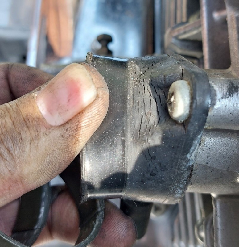

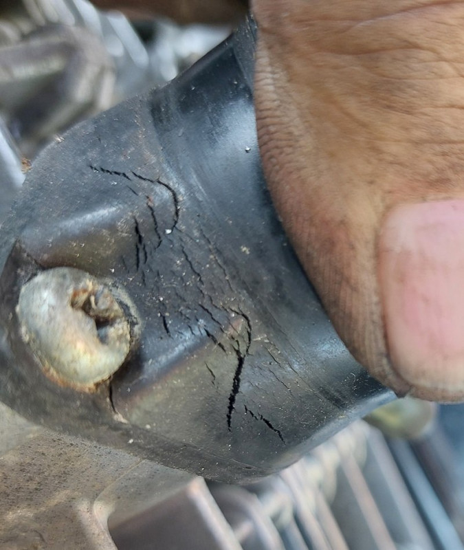

Definately sounds like an air leak, are the carb to head rubbers new ? If "yes" are they OEM? If "no" they are probably age hardened and cracked (could also be leaking between the manifold and carb) I guess the best solution if they are old is to replace with ideally OEM manifolds

Nothing last forever. Old cracked, brittle and leaking carb rubber boots cause most of the carb related tuning problems here in the forum!

18 May 2023 18:30No, those carb-to-head rubbers are the 1983 originals. You really think those can create the problem I wrote?Definately sounds like an air leak, are the carb to head rubbers new ? If "yes" are they OEM? If "no" they are probably age hardened and cracked (could also be leaking between the manifold and carb) I guess the best solution if they are old is to replace with ideally OEM manifolds
I think I'll have to replace them. However, this bike will be sold as soon as I'm done with it and 4x new OEM rubbers will cost about $200 CDN!! I've see some chinese units on eBay for about $20!!! CDN including shipping. I don't care how long they last as long as the bike runs OK after I fitted them. However, they will take 1~2 months to arrive here...
Any source for those after-market but priced between OEM and chinese?

18 May 2023 18:32Geez, those are old! I suppose mine are quite like that. I'll remove them tomorrow to be sure. Any source you are aware of for non OEM (ie: cheaper than OEM) but better than chinese's ?Nothing last forever. Old cracked, brittle and leaking carb rubber boots cause most of the carb related tuning problems here in the forum!

19 May 2023 08:57 - 19 May 2023 08:59Seen that way, I can hardly argue with you...
I'm more toward eBay and I've seen OEM there so I'll give it a look. Thanks!

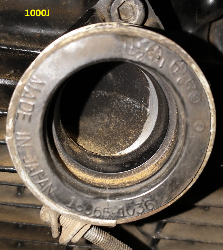

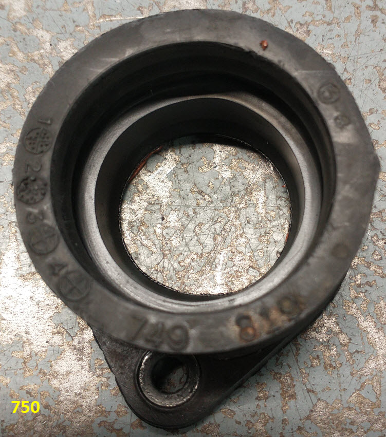

Well, I just did my old routine again… Removed seat, fuel tank, carbs and carb-to-head rubbers. They all seem to be still relatively soft and pliable. I "folded" each of them at 6 places around the perimeter and did not see any crack. They are not at all like those Scirocco posted the pictures of. I will order new units pretty soon but I'm far from convinced that they are the culprit…
FWIW, I compared them to KZ1000J's I have in my garage and they are the same, except for a +/- 3 mm larger distance between mounting holes. What make me wondering is that on 1000J's, OEM p/n is clearly molded in the rubber (which is also quite harder to flex).
On the 750's, there are a few numbers but nothing close to a p/n. Because of this and their remaining flexibility, could they have been replaced a long time ago with aftermarket units? Possible but I would be quite surprised.

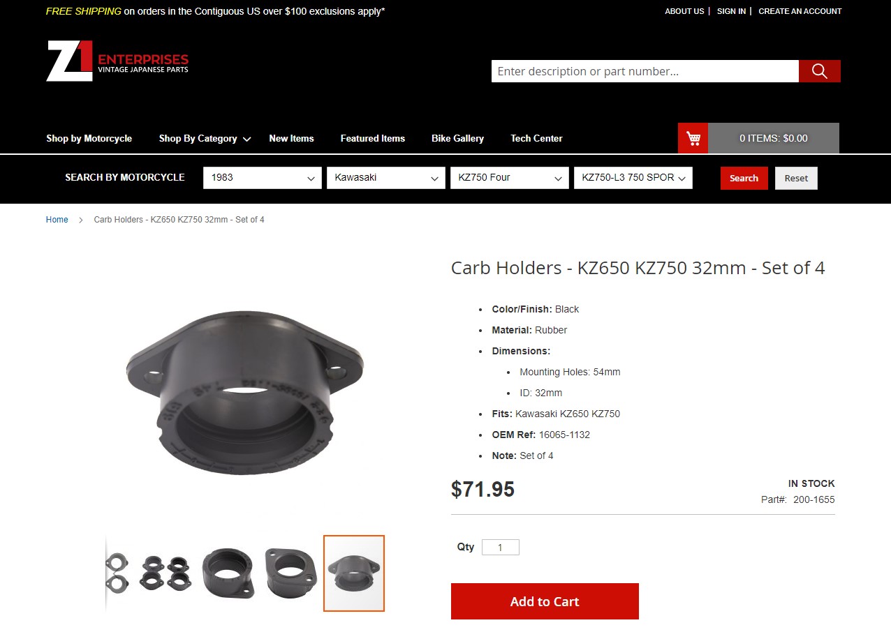

I looked at Z1 Enterprises pics and their 750 rubber do have the same 749 and 819 numbers (as well as OEM p/n) as mine so, I assume mine are 1983 originals.
