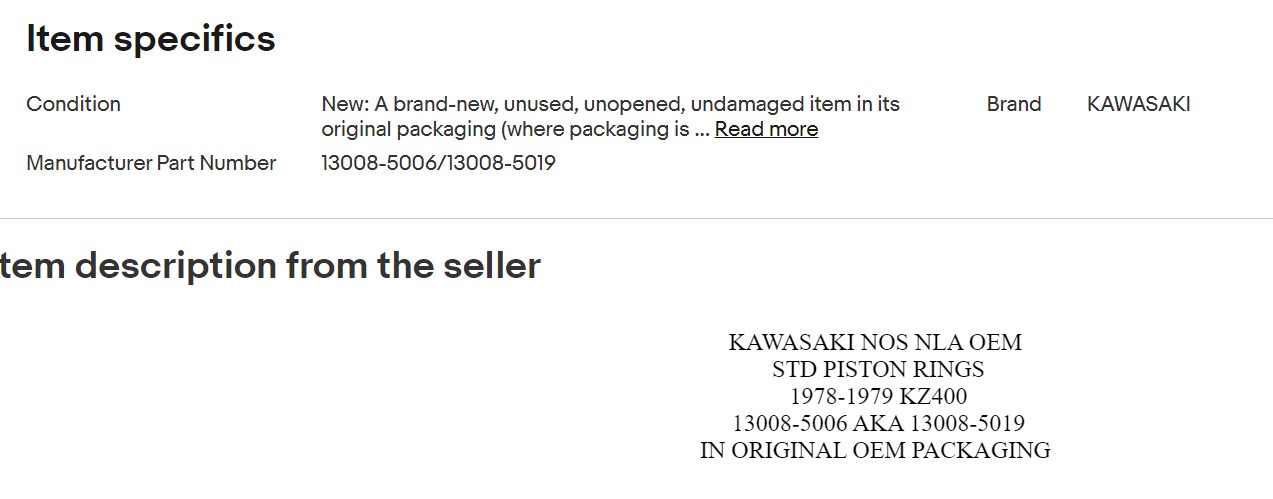

Partzilla list the 5006 number, CMNSL list the 5019 number, the below Ebay add suggests they are a supersession ??

Our Kawasaki parts price book, dated 09/05/1994, shows #13008-5006 is superseded by #13008--5019. There may be a service bulletin that denotes the reason for the change. Also, Mama Kaw often changed part #'s simply due to changing vendors.
