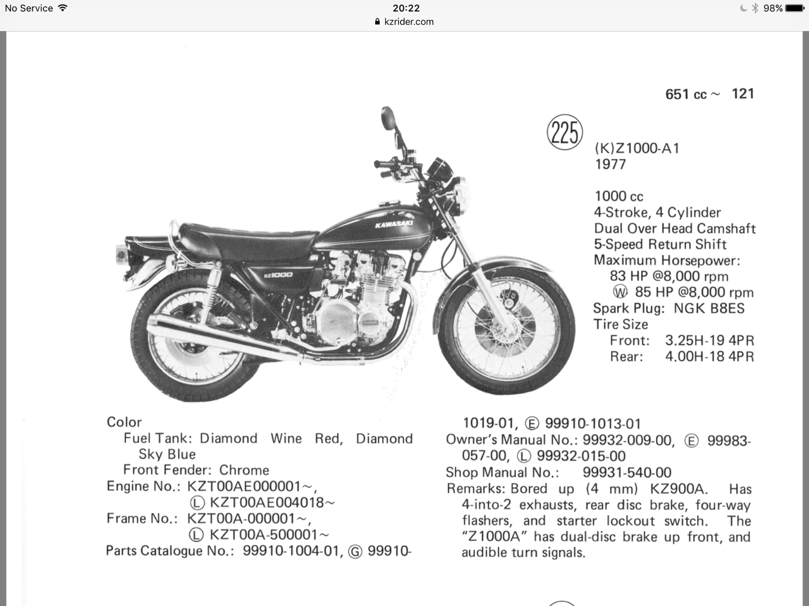

It looks to me like you are missing some characters (see below example) ? Check the model recognition" documents in workshop manuals under "Articles"

Click on the model for engine and frame no info.

You might find this useful, too.
www.kzrider.com/filebase?task=download.s...id=1178&catid=64&m=0
If you are asking about a 1981 or 1982 KZ1000J, the engine number should start with KZT00JE………..

I have not see an engine # like the one you posted ZT1035001799 ? Can you post a pic of the engine number? Not saying you have not but make sure you clean up; the location of the number.
As I understand it (not claiming I know all) the 1000, 1100 and 1300 engine numbers begin with KZT, then 2 numbers then 2 letters then the engine num. The two numbers that follow KZT, as I understand it, indicate cc size (00 = 1000. 10 = 1100, 30 = 1300 . Again as I understand it the 900s begin with Z1E and then numbers.
