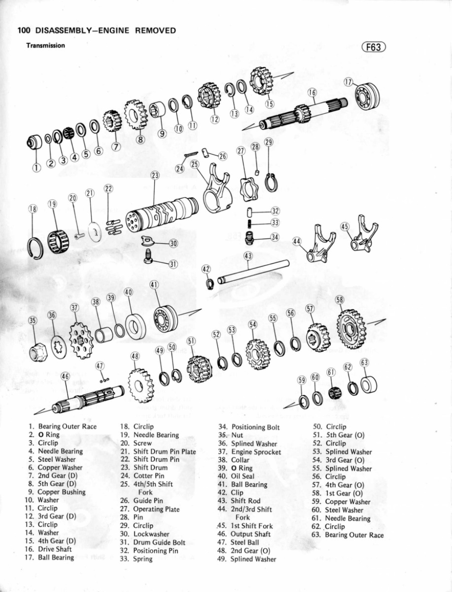

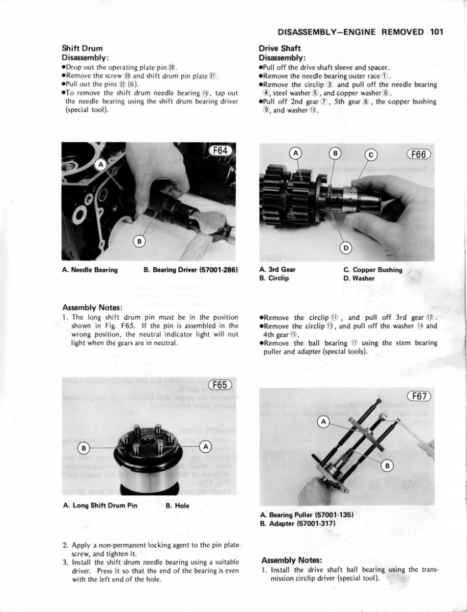

He most frequent cause of shifting problems is a broken return spring or pawl spring. However, if the drum has a lot of play, there may be a deeper problem.
Pages 180-184 in the fsm for the E1 covers the shift mechanism.
www.kzrider.com/modules/ServiceManuals/KZ750E1&H1.pdf

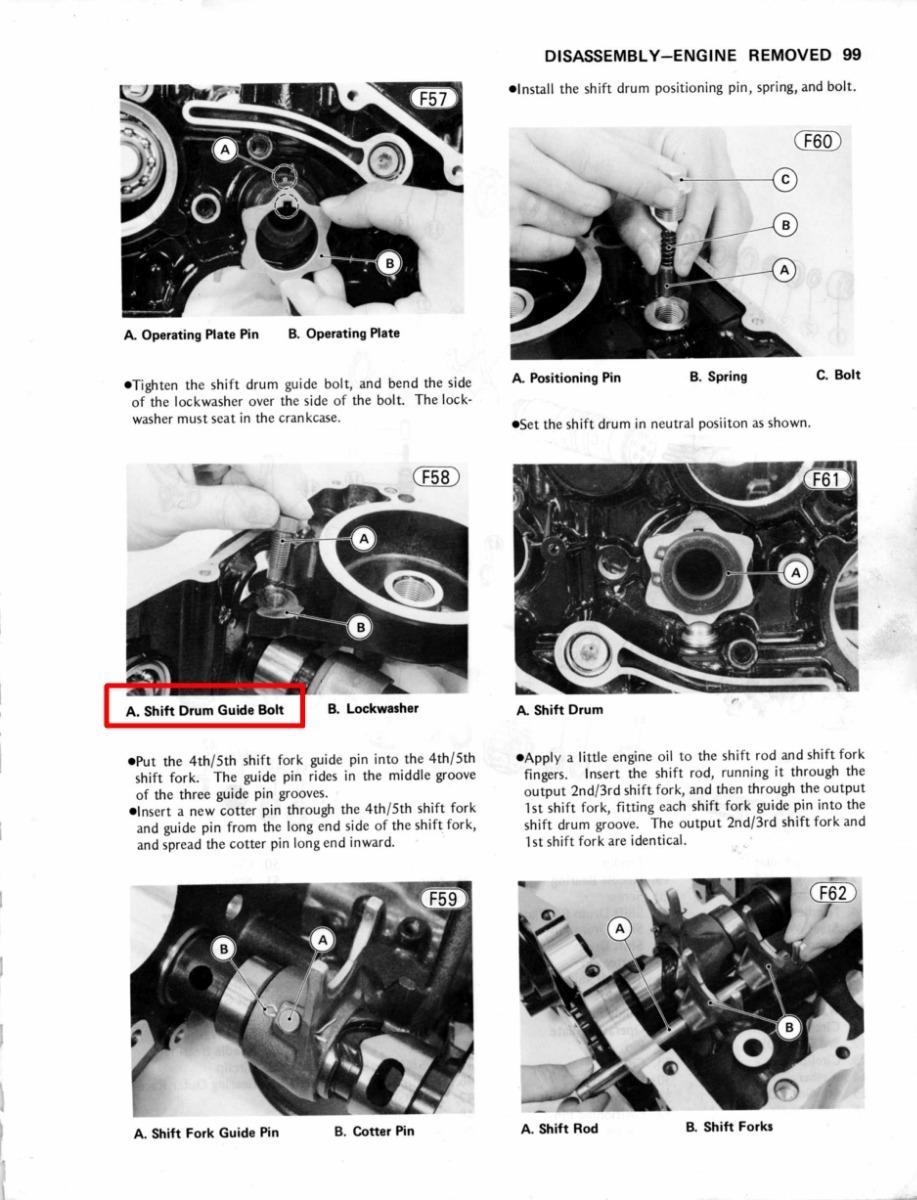

I see in the parts diagram that there is a locating screw (number 11). I wonder if slopification would occur if that was missing or loose?
www.partzilla.com/catalog/kawasaki/motor...chanism-80-kzy-50-e1

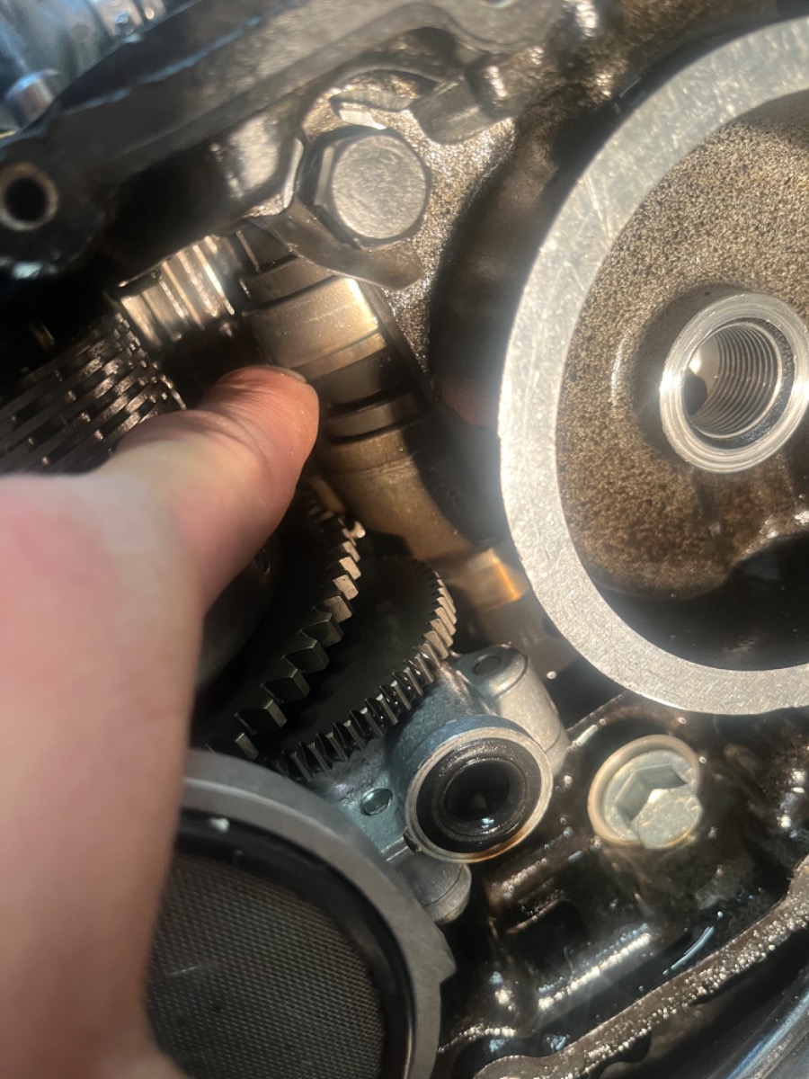

I did end up dropping the oil pan yesterday and found that the guide bolt was in fact loose so I went to fix that issue and found that the needle bearing(?) had somehow slid down the shift drum I believe. I’ll attach a pic. Is there a way to get that back in place from where I am (bike on its side and oil pan/sprocket cover removed) or is this going to require more breakdown?

Damn, someone forgot to bend the lock washer. Looks like you have to split the case but what goes out easy goes in easy.
Try cooler spray to shrink the bearing and heat to expand the case. Good luck.
