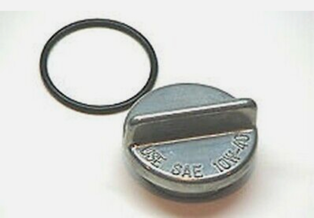

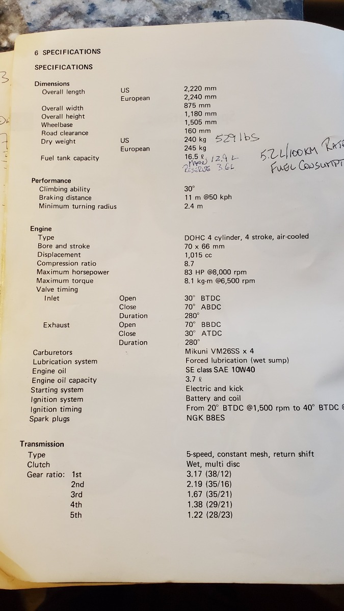

The manual and cap were published before synthetic oils were widely available. The manual also says nothing about modern tires, blade fuses, et cetera. Many things have improved since the 1970s.

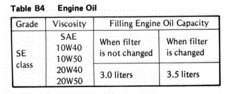

The manual doesn't mandate 10W-40. The chart below is from the 750 manual, but other manuals are similar. I'd stay away from the thicker stuff if you are riding in cold weather, though.
