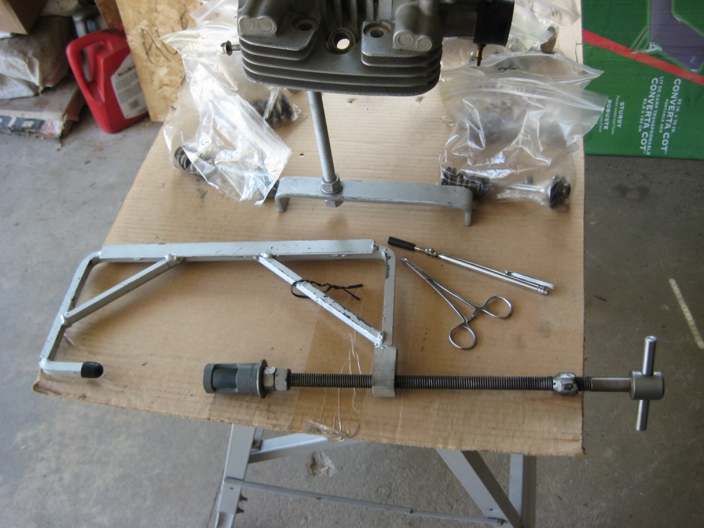

My spring compressor is home made so I am able to rock it back n forth, that lets me put one at a time on the valve stem. Then slowly unscrew the compressor while rocking so they both "catch" at the same time. Make sure to have a magnet on hand if one only catches.

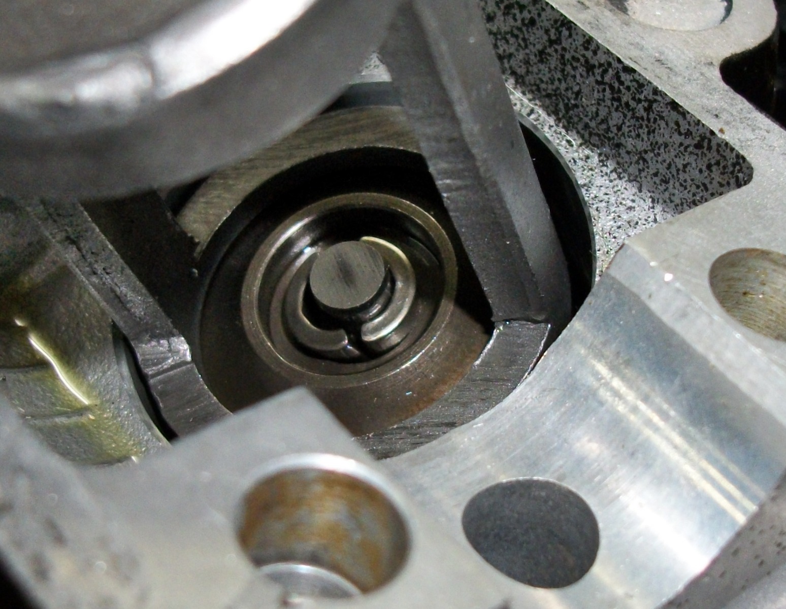

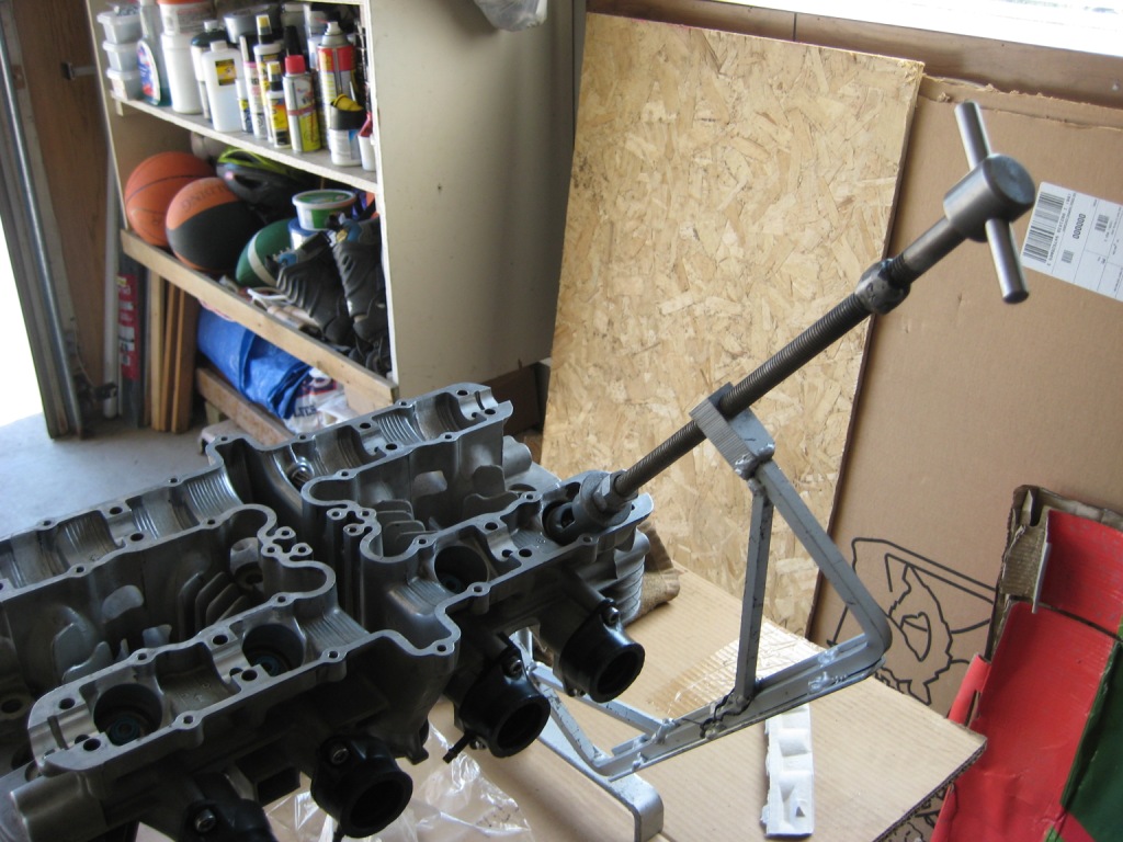

The plastic bag trick worked great on the intake valve. First attempt, 1 minuite. The exhaust valve, not so good. I think because I didn't have straight line pry point under the frame. After close to an hour of trying, I finaly got it.
I needed to get in there to replace the left valve seals. The bike smoked badly from the left exhaust since rebuilding the top end over the winter. Sure enough, I damaged the new intake seal during the rebuild. KZ305.

22 Apr 2023 08:39So you are not trying to compress the springs a minimal amount and slide the keepers in? I assume you are compressing the springs to a point whrere a greased keeper can just be placed in the proper position on the valve stem?I have used a spot of grease to hold the keepers in place
BTW I do have a proper valve spring compressor. I just didn't want to remove the head again. Compressing cotton rope against the valves worked well, they didn't move a bit.
