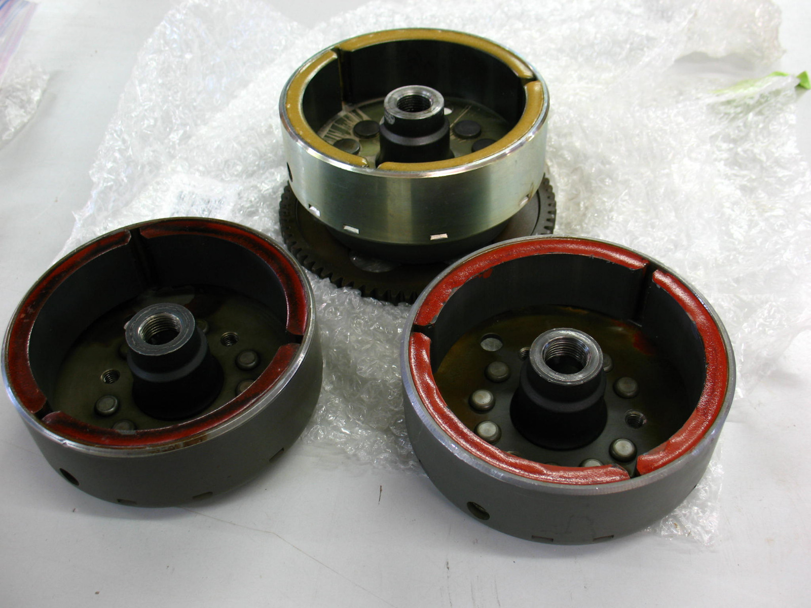

gonna see how well i can clean the two mating surfaces up and in such an oily enviroment too lol
thanx
IMO, don't waste your time and a perfectly good gasket.  Scrap the thing and buy a used three-magnet rotor off ebay from an 1100 or 1000 J engine.
The one pictured with the starting clutch below was installed five years ago, and is still going strong.
