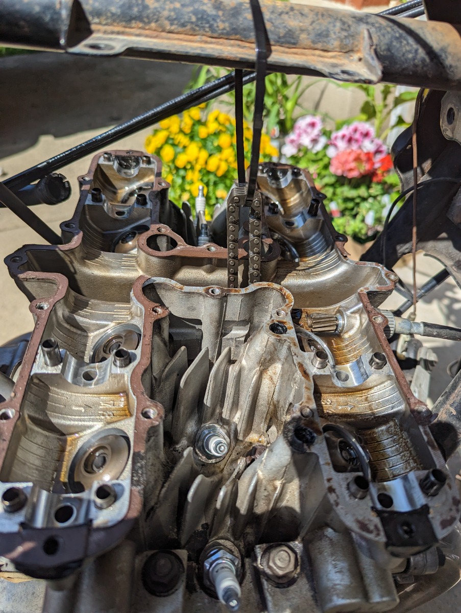

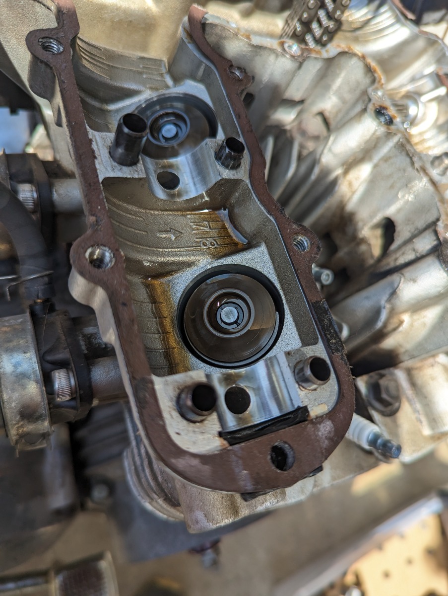

Okay so after not being able to touch the bike for a few days, I finally got around to pulling the cams after checking the clearances again, properly. 3 of the 8 were at the low end of spec, and the rest were under spec.
Now, I'm a little lost. There aren't any shims, are there?

Reply to say that I am in fact an idiot, and the shims were all stuck to the inside of the buckets.
It looks like I can swap around 3 of the shims to other buckets, but I'll have to purchase 5 of them.

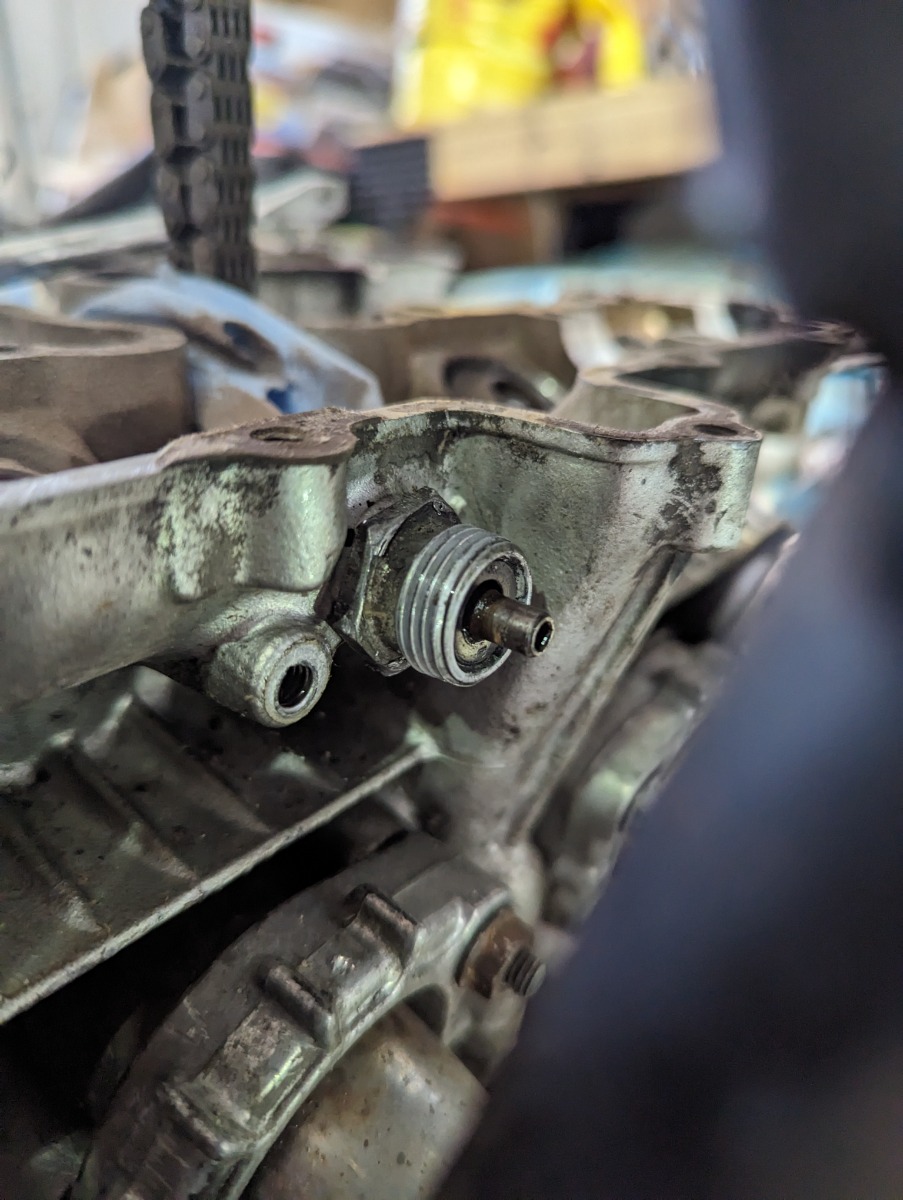

I took it out after I took the picture, I couldn't find the right size hex key at first.
Is there anything else I should worry about or is worth doing while I have the top off? Getting the gasket cleaned off is going to be a pain. And it looks like a previous owner did something in here at some point. One of the cam cap bolts was not a stock part.

Okay so I removed the allen bolt holding the pinion in place but never removed the worm gear. I'm back at it today and really struggling to figure this out. I've got the pinion to turn, but it's not backing out. Any ideas?
Re: 1982(83?) KZ550 C
21 Apr 2023 17:13
Knock it out with light taps and a piece of a wooden stick on the worm gear. Some heat will soften the binding o-ring.
