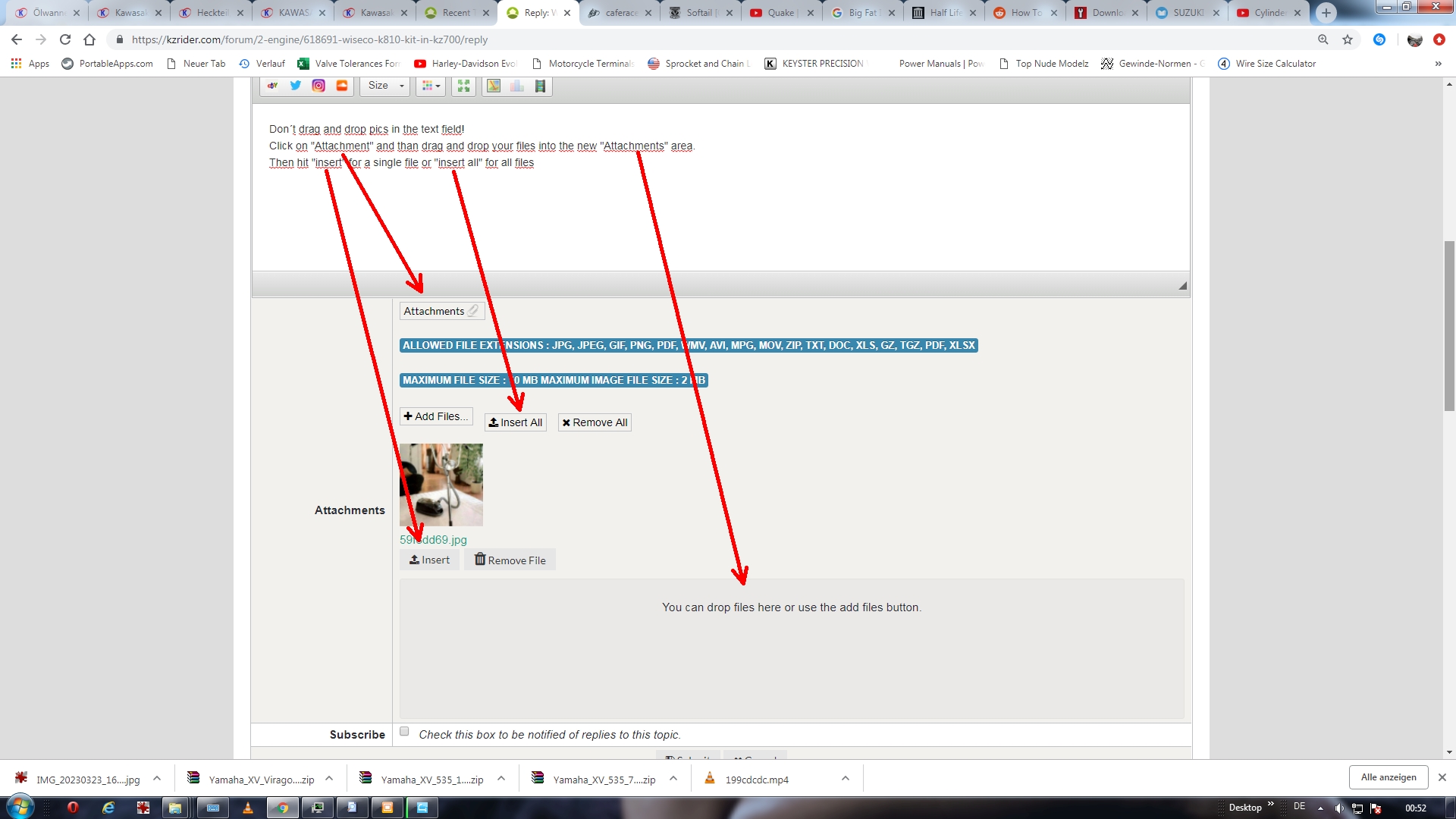

Don´t drag and drop pics in the text field!
Click on "Attachment" and than drag and drop your files into the new "Attachments" area.
Then hit "insert" for a single file or "insert all" for all files
