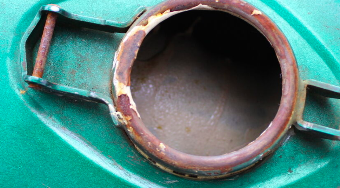

Is this KZ TANK unuseable?

Re: Is this KZ TANK unuseable?
21 Mar 2023 06:30
That tank looks to have a liner inside, Kreem most likely, which has a spotty reputation. If it were my tank, I'd strip the liner, then properly derust it to see if there is any weakness in the metal. If the metal is thick and strong, a decision about sealing the tank could be made at that point.
In other words, getting your green bike going isn't going to be as simple as buying a used tank and taking it over to a painter. With ANY 40+ year old tank, the best thing would be to fully strip all the paint outside, then derust inside and out. There are shops that will do this for you, but I have no idea how much they charge. Radiator shops maybe? A car body/frame shop with full dip tanks would be ideal.
21 Mar 2023 07:47ThanksThat tank looks to have a liner inside, Kreem most likely, which has a spotty reputation. If it were my tank, I'd strip the liner, then properly derust it to see if there is any weakness in the metal. If the metal is thick and strong, a decision about sealing the tank could be made at that point.
I have a tank on the bike already but ironically I dropped it the other day and it has a few more scratches on it. Nothing major but the tank needed painting anyway and had a slight dent upfront, so I dont care.
I was going to buy the spare tank, which you saw the pic of. I guess that makes no sense. I know my tank is rust free and solid, so I'll just take that over to the car/body shop with has agreed to color match (metal flake included) my tank and rear fairing, and paint them both for a total of $650.
