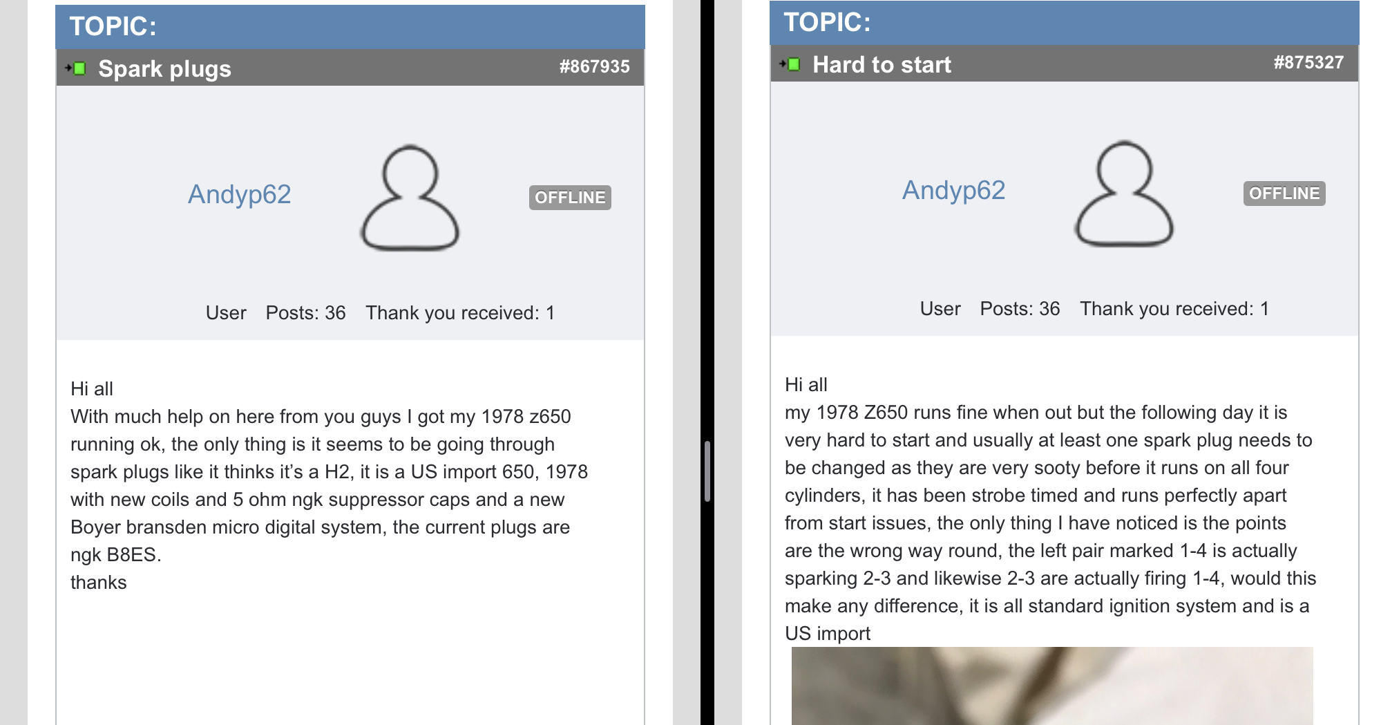

Pleas update us. We need correct information to help you.
May 2022 you post pictures of sooty plugs and claim it’s brand new Boyer bransden micro digital system.
Then on October 2022 you post sooty plugs again but claim it all standard ignition.

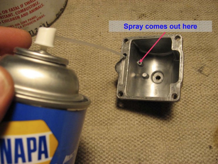

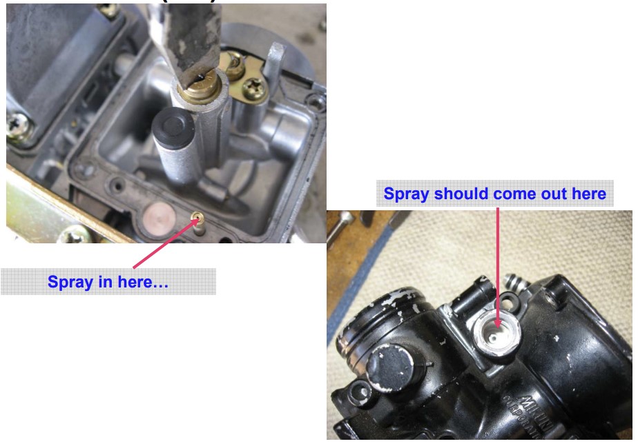

The choke pickup passage in the float bowls may be blocked. Or, the passage in the carb between the brass choke pickup tube, and the choke chamber at the plunger.
Last edit: 18 Mar 2023 15:00 by Nessism.
The following user(s) said Thank You: ThatGPzGuy, Scirocco, howardhb, Wookie58, Andyp62
Re: Hard to start
18 Mar 2023 16:25
Nessism
gives a very important info about the cold start procedre (richer air/fuel ratio).
These special points of cleaning the carb enricher circuit is often missing during a "carb rebuild or cleaning".
